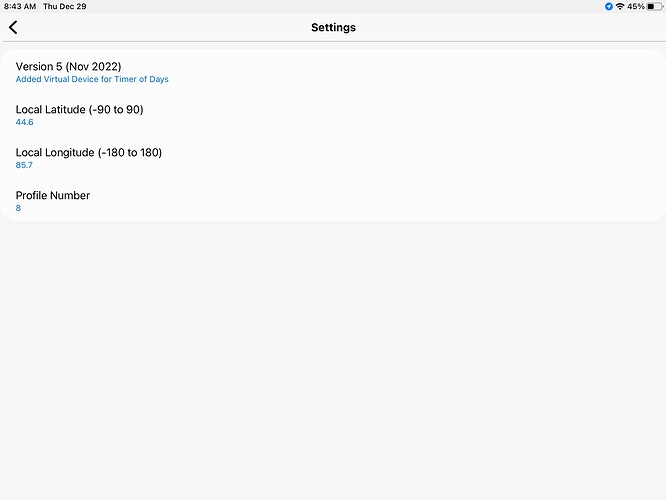

Hi Marino.
I’m trying to use the virtual calendar for sunrise/sunset in a routine since the smartthings native sunrise/sunset don’t update. I enter my lat/lon and my tz offset and I get some really funky numbers.
If you are living in USA longitude have to be negative
Thank you. That sussed it.
