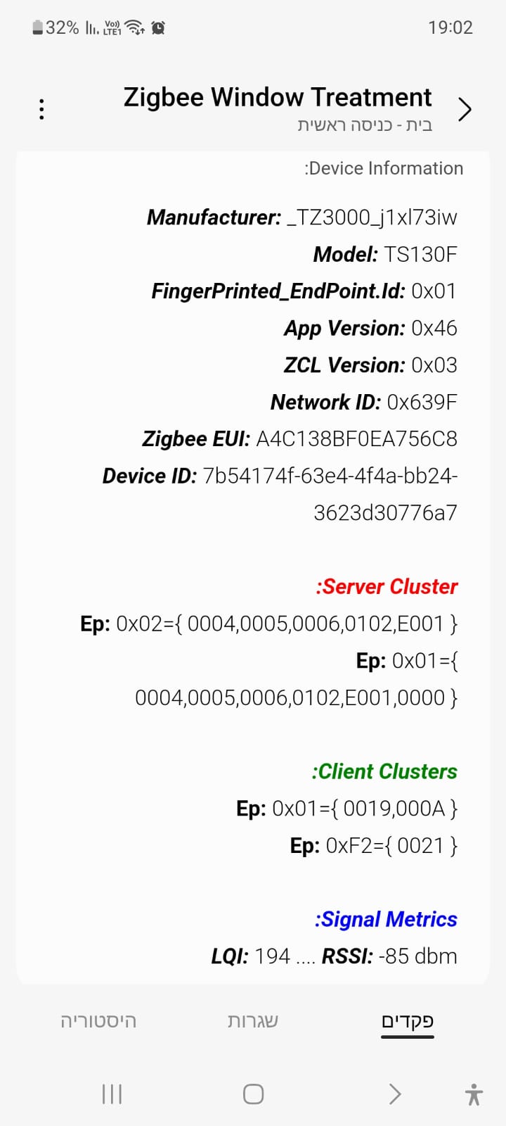

Will this edge driver work for the Yoolax motorshades, it has the Z425 Zigbee motor. I see on the github page you have the source for it.

Just wanted to inform that @w35l3y Default Clusters driver can deal with this module. BUT, without the option to calibrate the % , as in your single gang shutter driver. In order to calibrate the % a Tuya Hub is required on which I want to prevent. I still hope you’ll find few hours to develop this as well.
