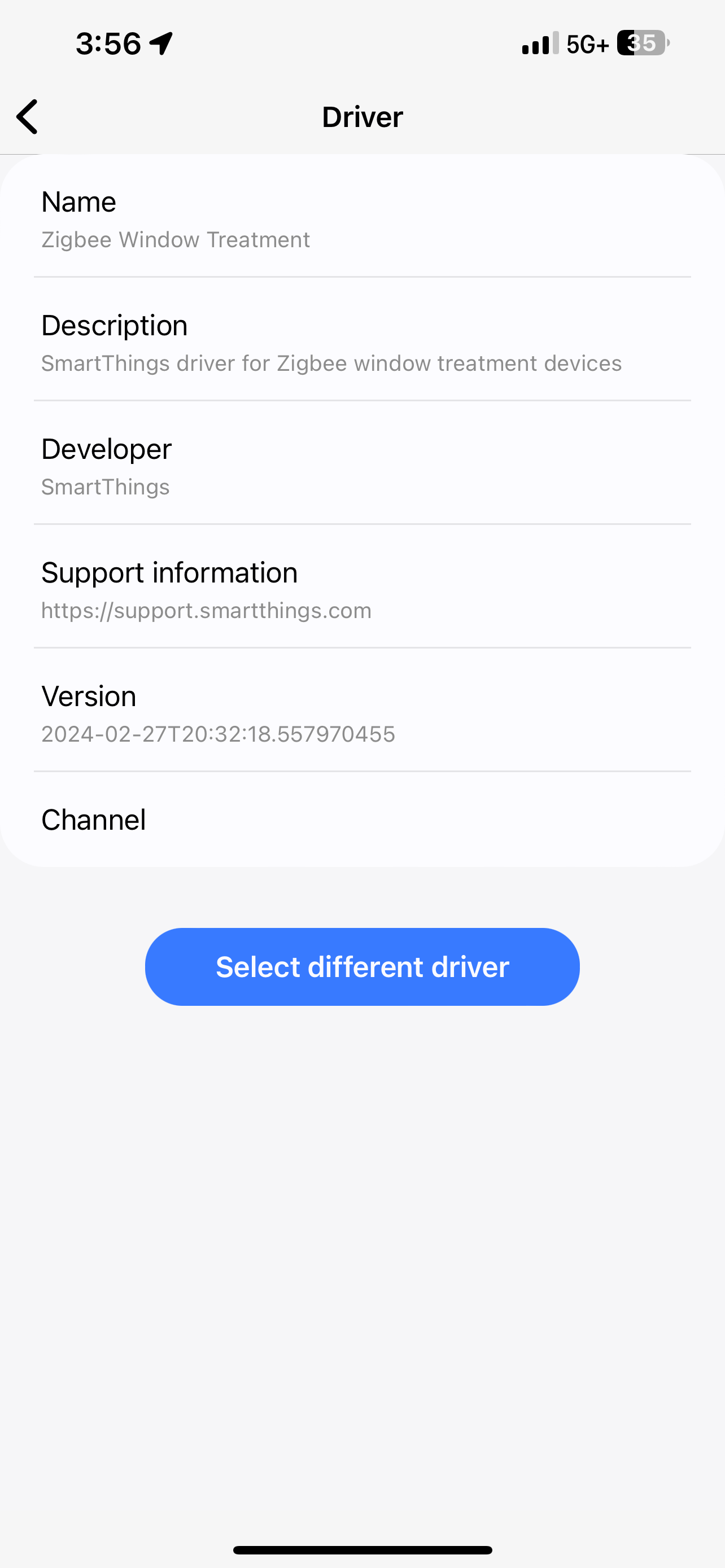

I am currently using the stock driver (see screenshot for defualt driver below) and it works perfect except one thing that drives me crazy. When the blinds are open, smartthings reports it as closed and when the blinds are closed, smartthings reports it as open.

Driver being used:

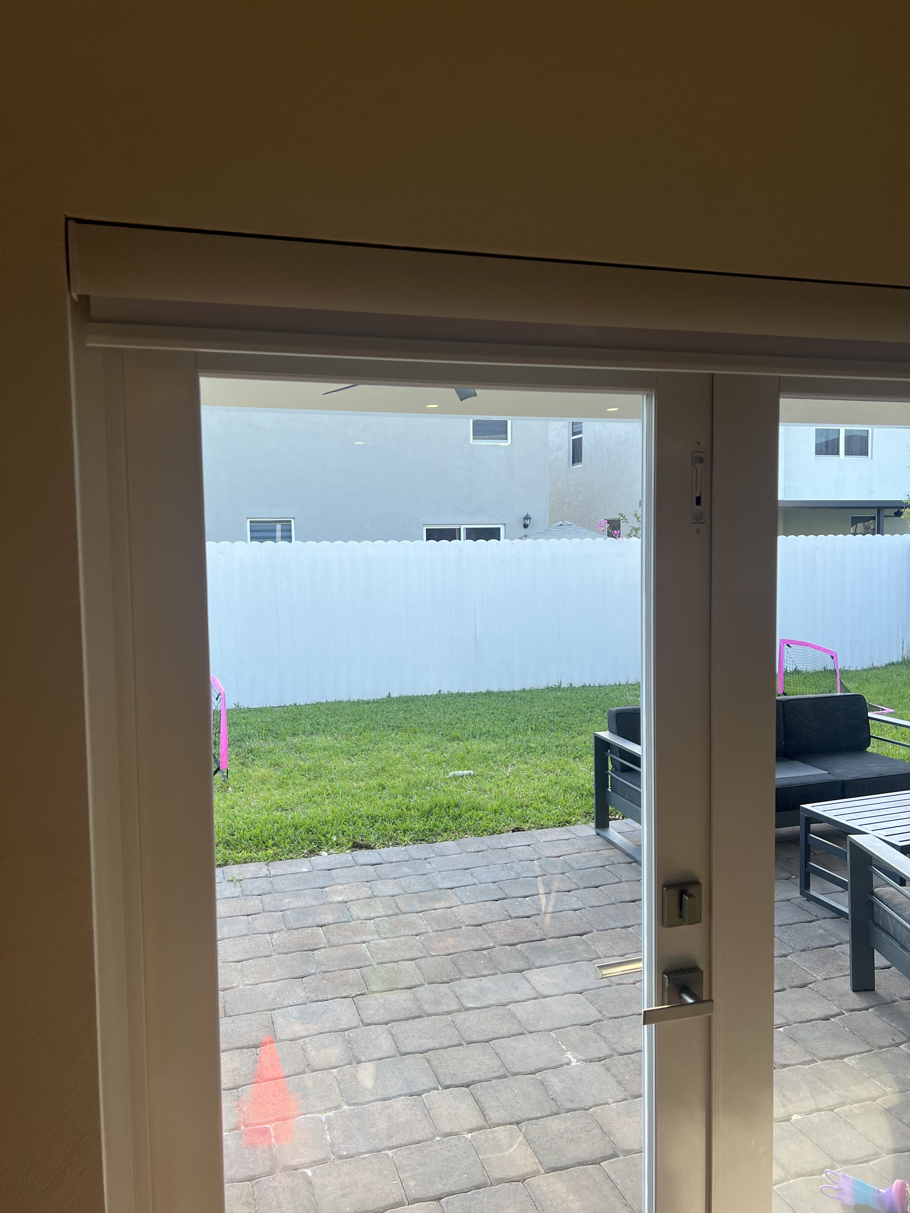

Blind are currently open right now but smarthings shows closed.

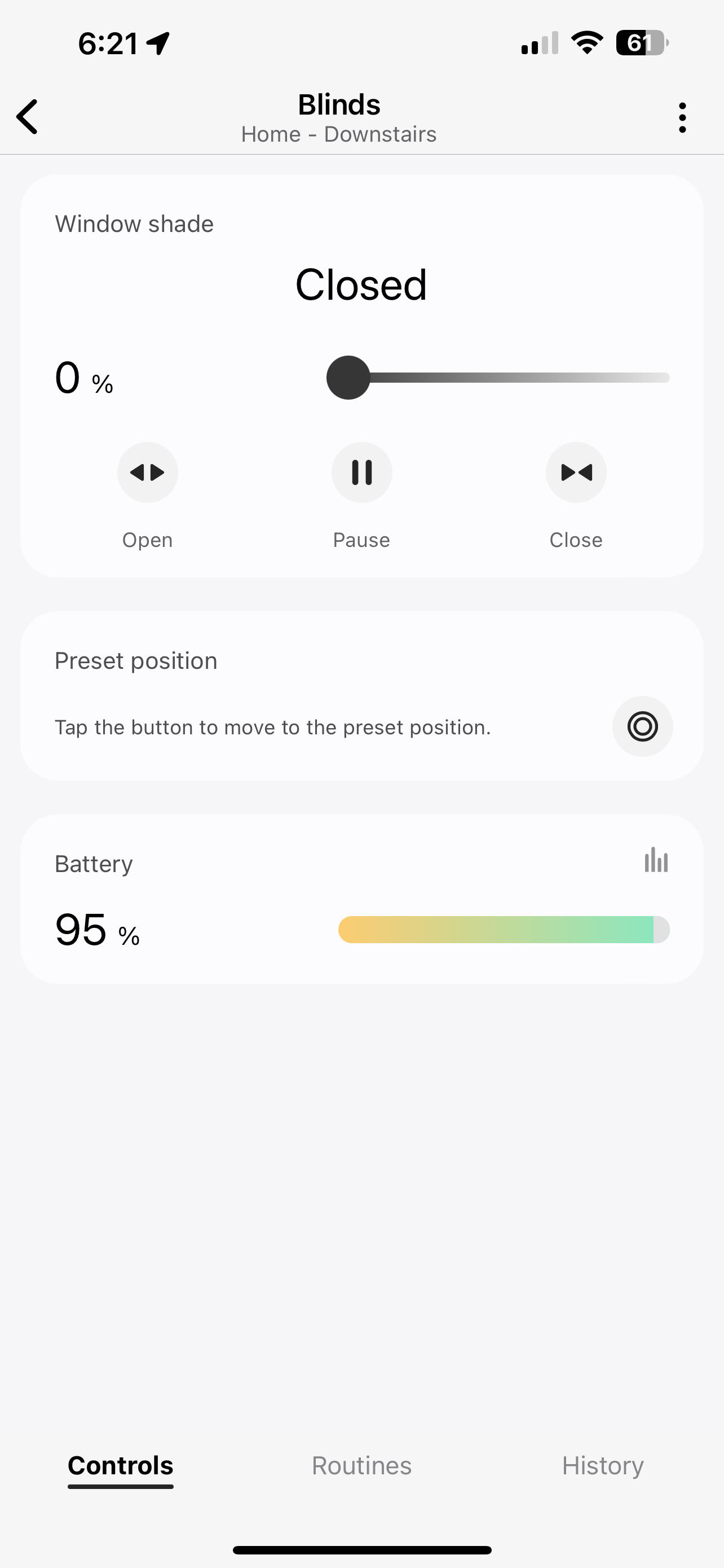

However the status of the blind is wrong. When it’s open, smartthings still shows it’s closed and vice versa.
Please see below. From what I read it has something to do with my motor being on the left side instead of the right side.
It seems I just have to flip the status code but I have no idea how to do that.
Your latest shared driver
Smarthings show it’s closed
The physical blind is open
