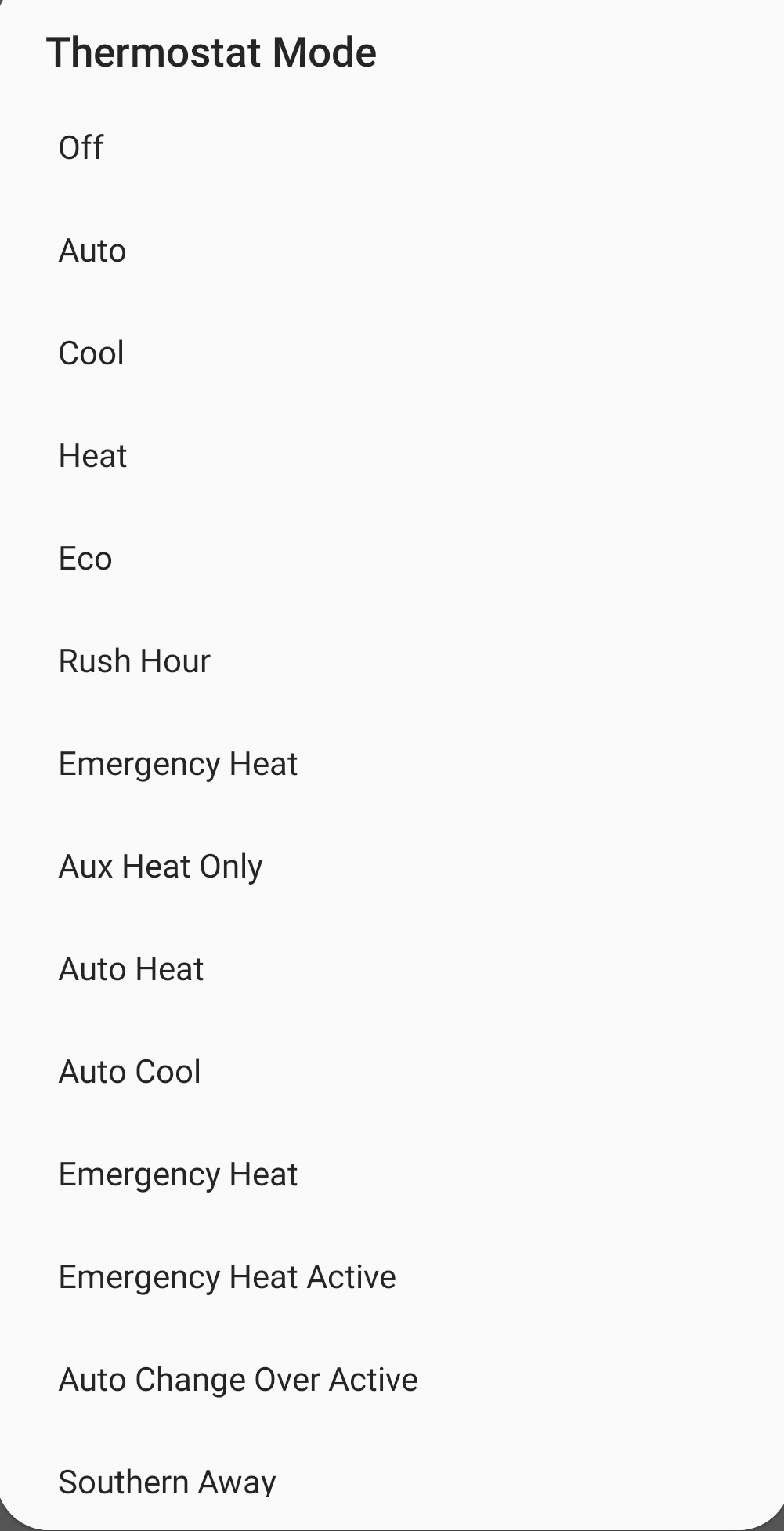

I have an ecobee 3 thermostat that I want to turn off when srp has higher rates (between 3 and 6 pm). I was able to turn the thermostat off at 3 no problem, but I not sure what to select to get it back on with the same settings and schedule before it turned off. There isn’t an “on” option. I tried “auto”, but it stayed off. I was going to try “resume” tomorrow, but I thought someone would probably know the correct option without me having to guess and check. (Some of the options are in the picture.)

Actually it was on auto before. With the auto setting it will switch between heat or cool. I could probably set it to cool and then change it every season, but I was hoping just to set it back to where it was.
Yep, auto is what I have it on in ecobee. When I turn off the thermostat in smartthings, and I try to turn it back on with the “auto” setting (from smartthings) it didn’t turn back on. It sounds like you are saying “auto” was the correct thing to choose in smartthings, so maybe the signal just didn’t get there on first attempt.
Thanks yvesracine. I wanted to keep it simple for now. So I was just trying to figure out if “auto” for smartthings is the “auto” for ecobee. Or if smartthings should be set to “resume” or “Auto Change Over Active” or something else for ecobee to return to “Auto”.

Yep, just did a code review, and their DTH actually changes the list of supportedThermostatModes to be on “off” when you set it to off. And if it’s in Auto mode, you can’t change it to Heat or Cool either! It is not what they intended, but it is a definitely a bug in their code - you’ll never get it to work unless they fix the bug (in generateEvent(), if you want to report it to them). It won’t work from WebCoRE either, FWIW.

Tell them that in generateEvent() within the file ecobee-thermostat.groovy, they initialize the list of supportedThermostatModes to be ["off"], and then only add other modes if they are ever engaged. So once you turn it Off, the list is left to be only ["off"], which guarantees that you can’t turn the thermostat back on again.
