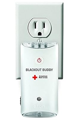

So I would consider additional approaches, such as battery-operated emergency lighting in your home that turns itself on after a power outage. We live in the San Francisco Bay area and have several of these plugged in. They can also function as flashlights when removed from the outlet.
That way if your power and Internet are still working, you get the alert from IFTTT. But if your own power is out, the emergency flashlights still turn on.
