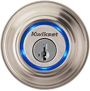

Anyone forsee any problems with the Kevo from Kwikset? I’m looking for a deadbolt with no keypad and the Kevo looks pretty slick.
A few… It’s bluetooth and doesn’t have an open API :slight_smile:
