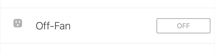

The plug is off and does not turn on

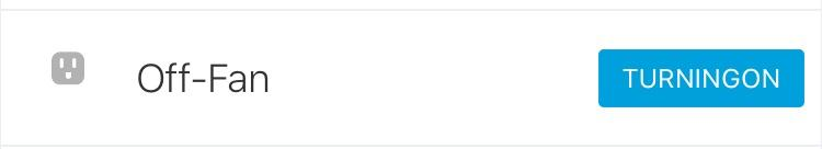

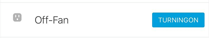

The plug stays on while showing off status
When I try to turn on the plug, I get this error in the new app.
