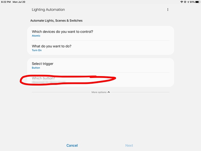

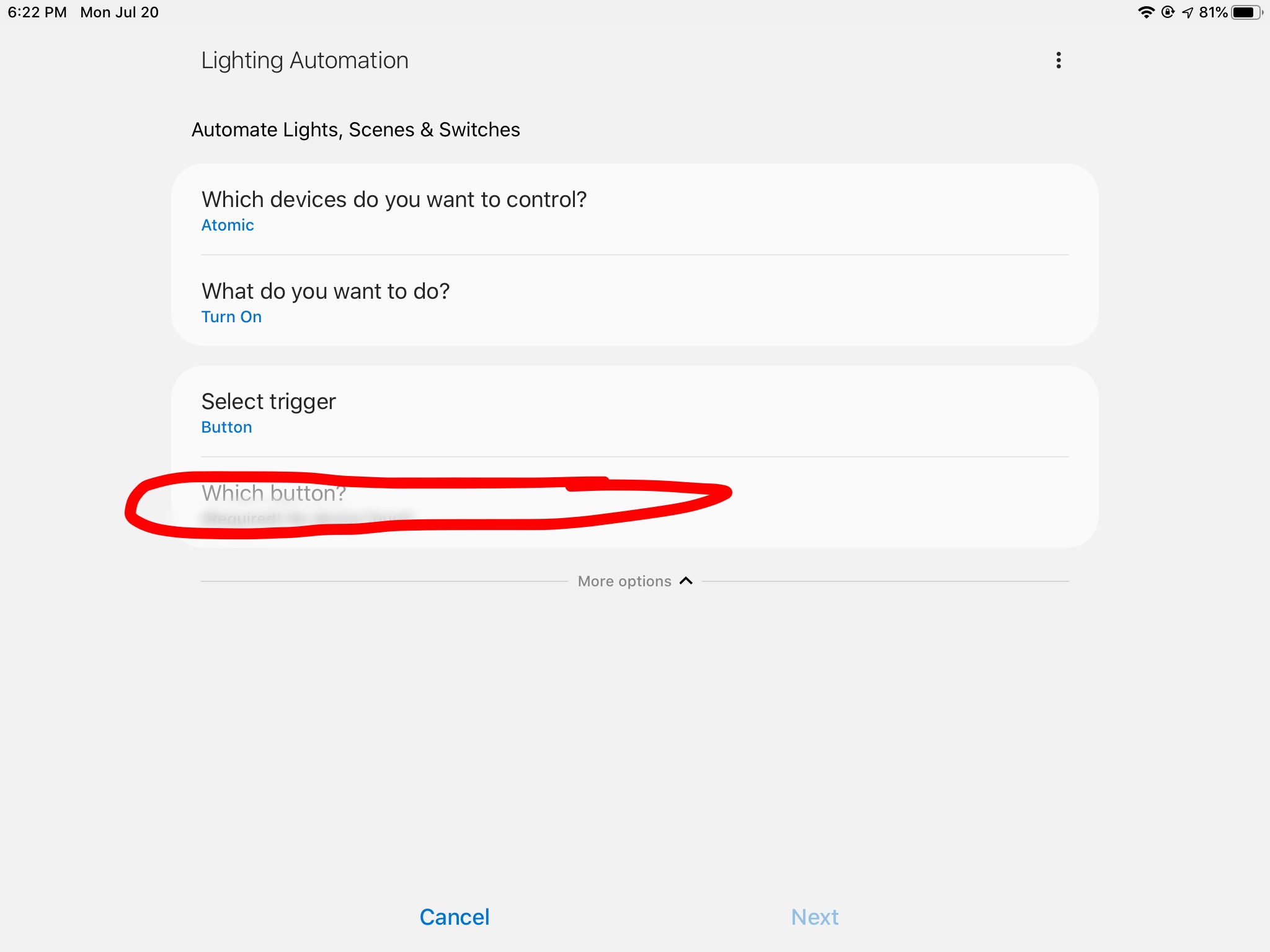

Number of Buttons indicates how many different buttons a device has. Then you can assign a different action to each button, using, for example, the official smart lighting feature.
Is that what you were asking?
3 buttons
4 buttons
That’s exactly what I want to do.
But that didn’t work for me so instead I separate components for each button.
Thanks you for about your answer, I’ll try it more.
I’m not sure what “didn’t work”. The numberOfButtons is simply the number of buttons the device has.
Using components is exactly what you need to do with the new app and is generally the way to go.
