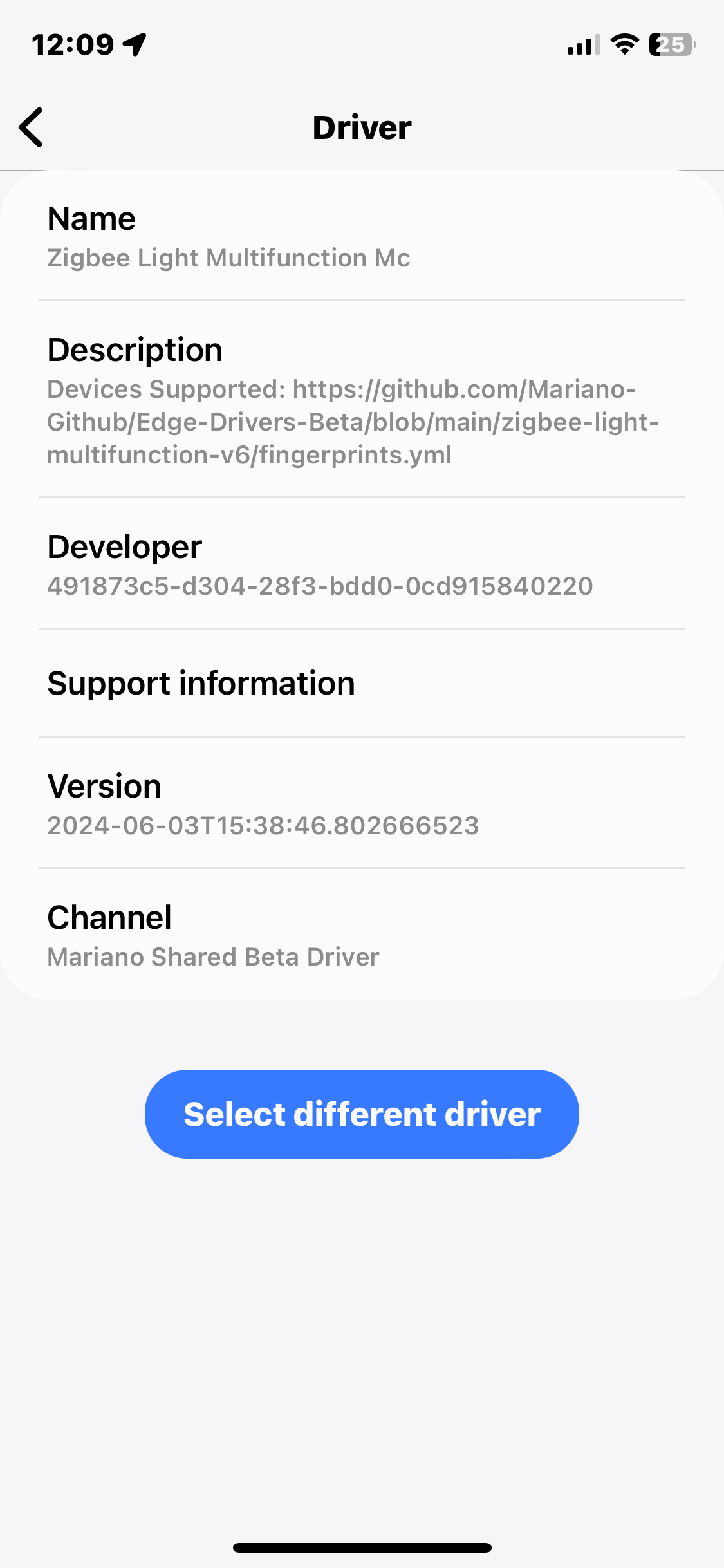

So I have some zigbee zemismart lights that I originally had directly connected to smartthings using a driver from I believe mariano. They worked perfectly
I recently bought the MOES hub and switched them over to MOES and then through matter they connect to smarthings. They mostly work with whatever driver pops op. But… I like my lights soft white and if I say “alexa set the lights to soft white” it doesnt change them. I can say other colors and it works fine but for some reason it is strggling with soft white. Which this did previously work perfectly. Everytime I want to get them back to softwhite I have to open the MOES app and set it.

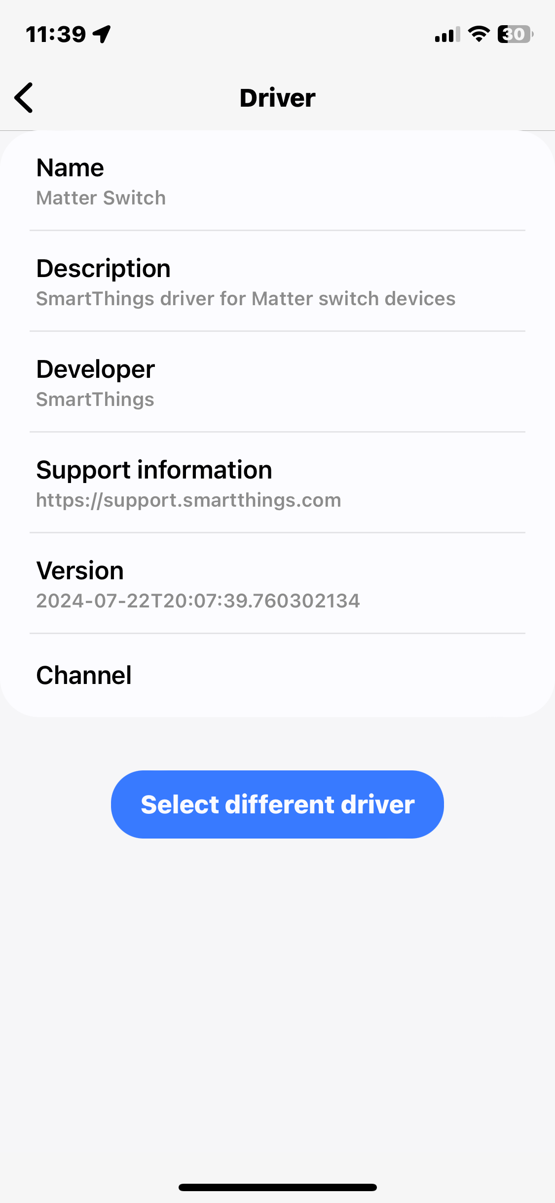

I see your point now. OP should check if the SmartThings app can control the light, if everything works fine within the app it’s not the driver. Maybe Rules or Alexa are not invoking the correct capability for whatever reason.

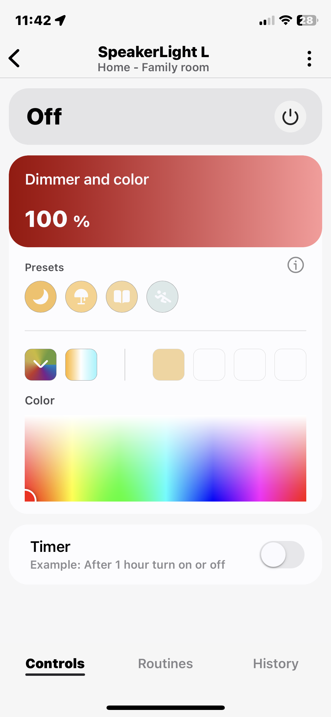

No if you try to set the color based on temperature in smarthings it just spins and does nothing. I am fairly sure this is an issue with the smartthing driver and not Alexa. As this all worked perfectly with Mariano driver when the lights were directly connected to smarthings and not through the matter bridge. The interface provided by the matter driver in smarthings is completely different then what was available with Mariano driver.
I can set “white” I can not change the color temperature. It will just spin on the temp change and then time out back to 4400k
Then it has nothing to do with Alexa. I don’t think it’s the driver either, the code to change the temperature is quite trivial and any other driver would do the same.
By the way, the new interface is not about the driver, they just updated the presentations recently in one of the app updates. The capabilities used in the interface are the same in Zigbee and Matter drivers.
It could be something in the implementation of SmartThings managing the bridge (but then it would fail in Hue or Ikea bridges and I don’t recall reading that) or in Moes just not following the protocol.
If you happen to know how to launch the logcat with the command line interface (CLI) it would be possible to know what’s happening looking at the logs when you try to change the temperature.
Does it work in other Matter ecosystems? It would be a good test to know who to blame here :slight_smile:
I’ll try and figure it out after work today. Any wiki?
The CLI can be installed from here: GitHub - SmartThingsCommunity/smartthings-cli: Command-line Interface for the SmartThings APIs.
To get the logs run in the command line: smartthings edge:drivers:logcat , I don’t remember if it asks things the first time, but eventually it will ask to select a driver, pick the number for Matter Switch.
Then change the temperature of the light from the SmartThings app. It should look like this (actual trace from my WiZ lights, they are not bridged but should not be much more different):

changing temperature doesnt work. Changing color works

I can change it to soft white from MOES app directly. But from smarthings side temperature control does not appear to work.
Just to confirm, while you are logging, when you select a temperature from SmartThings app nothing happens? No lines of log at all?
In that case looks like an issue with the app or the SmartThings cloud or something internal that does not call the driver.
correct nothing happens

I moved most of the lights back to smarthings directly using the Mariano driver and the lights work perfectly again. So maybe comparing with the Mariano driver would be helpful?
Wonder if it is a similar issue they were previously seeing
OK! Then maybe @nayelyz or @Luis_Humberto_Medina can check what’s happening since it looks like the temperature control is not invoking the driver at all.
Working driver that’s using SmartThings directly and lights work perfect.
