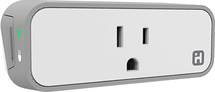

IHome has a really nice $50 multisensor that includes an acoustic sensor designed for home automation (rather than home security or as a baby monitor). It also reports lux, temperature, humidity, and motion. The only problem is even though most of the multisensor features also work with HomeKit, the acoustic sensor doesn’t integrate with anything except their own app. So you can use it to turn on one of their pocketsockets and have that coming on be a smartthings trigger, but that’s adding additional cost and complexity. Still, this may be the best choice for many people as long as you’re willing to add the Pocketsocket as well and use its own app to set up the trigger.

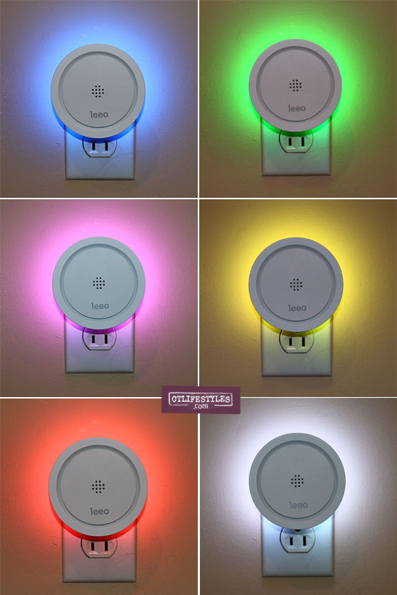

Since people may find this thread with a different use case in mind, I did want to mention that I do personally really like the Leeo plug in acoustic sensor for security use cases, but it only monitors for specific sound patterns: US smoke alarms, CO2 alarms, and the continuous alarm tone issued by many leak monitors.
It doesn’t integrate directly with SmartThings, but it does have an IFTTT channel.
It also functions as a notification light, since it has an RGBW light ring which can be set through the IFTTT channel.
At our house we have a bunch of regular four dollar leak detectors which are not networked to anything, but if they alarm, the Leeo will send us a phone notification. We also used to use it for smoke detector alerts before we had networked smoke detectors.
It retails at $49.99, but is often on sale for 10 or $15 less.
It works very well for that specific purpose, but you can’t use it as a baby monitor or for loud music or anything like that. It’s just listening for the specific alarm patterns.
