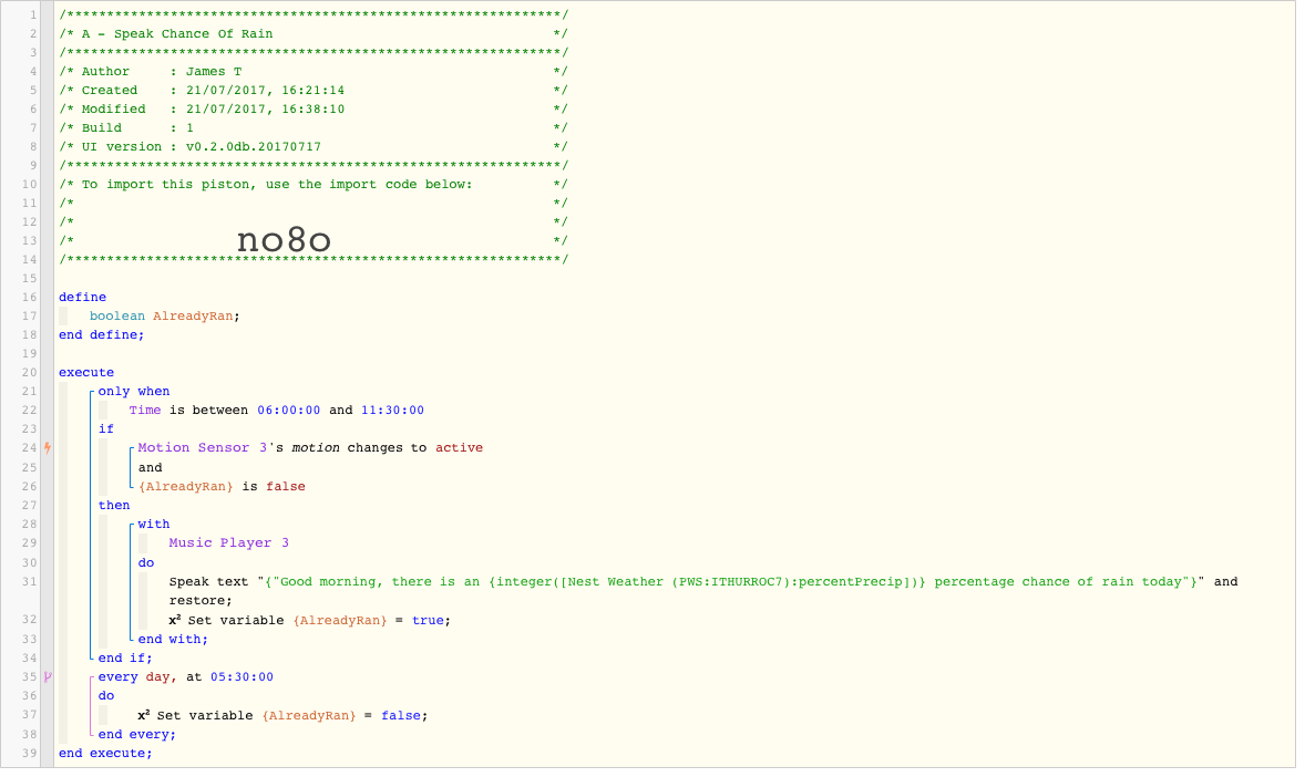

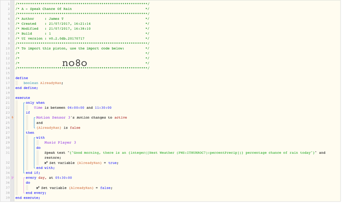

Another example. Chance of rain report spoken from a connected speaker (in my case a Sonos player) and using the Nest weather device:
