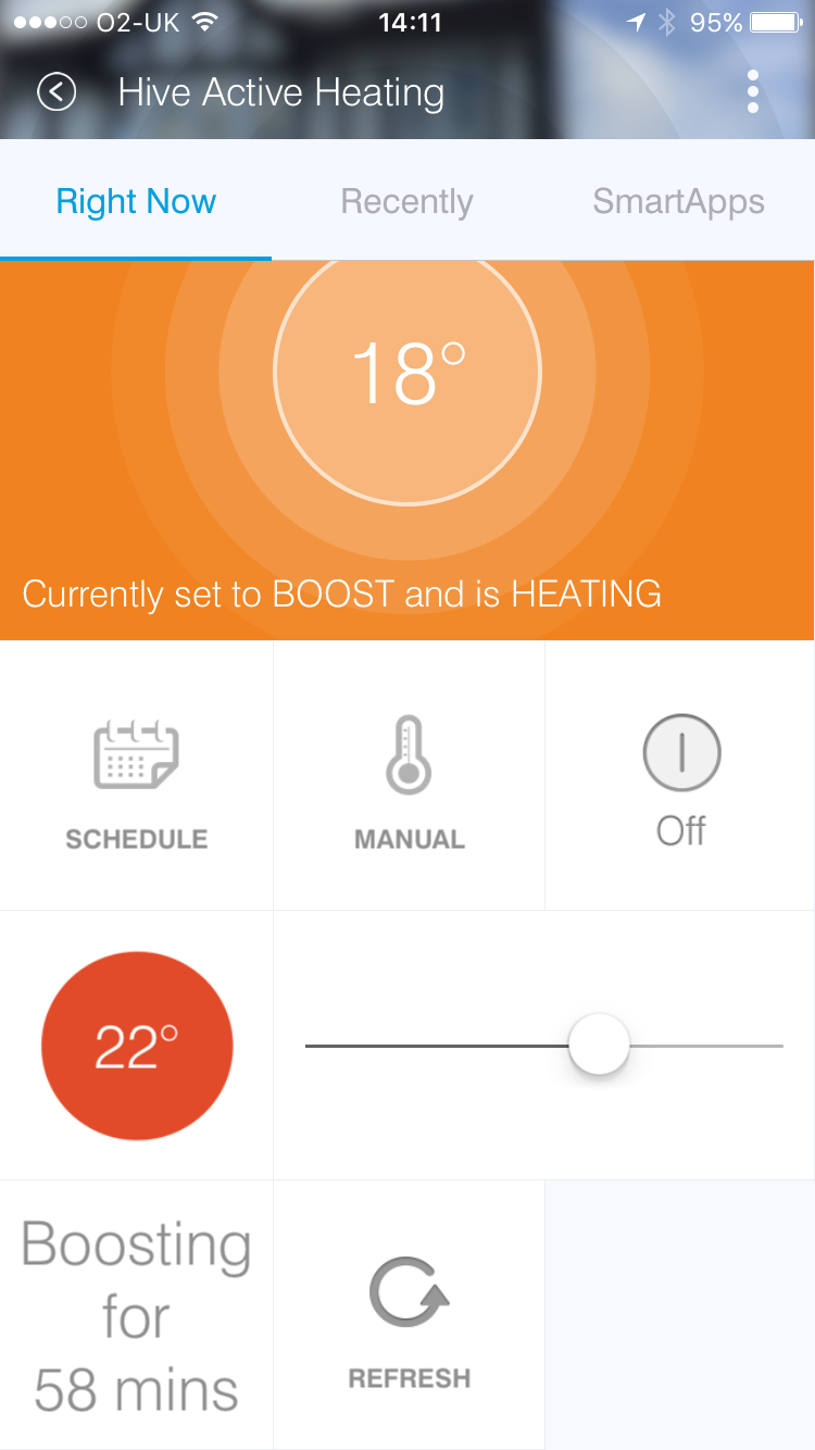

v1.10 - Boost mode has now been added and other tweaks!!
Consider the boost button a bit of beta as didn’t want to stress my boiler by turning it on and off too much in quick succession. Please let me know if you see any issues especially around switching into Boost and back to Schedule/Manual/Off.

  6. When starting boost it isn’t possible to stop by pressing the same boost button.

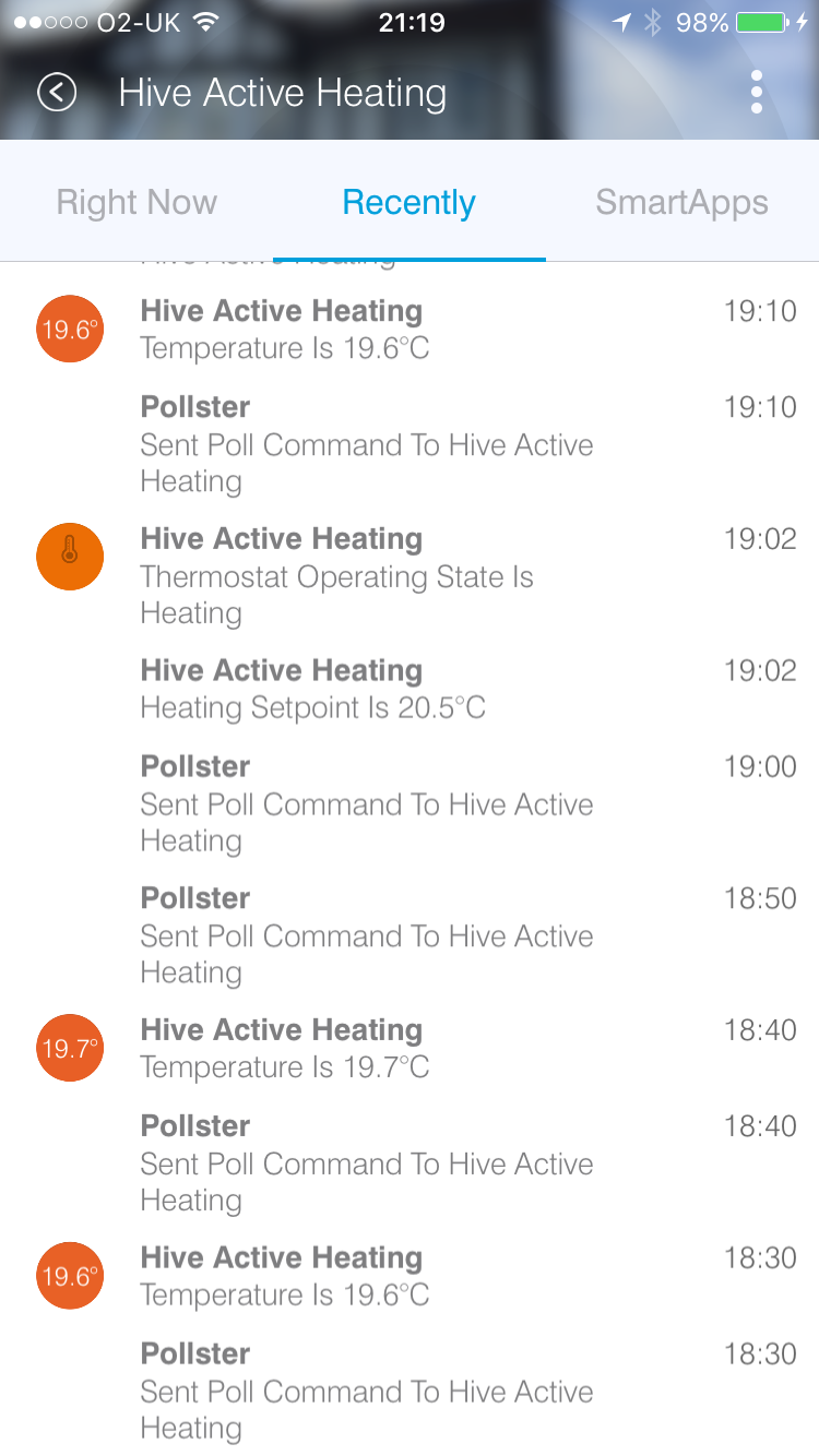

For point 5, this is set to update/poll after 4 seconds and does refresh automatically for me. The long delay is there as Hive does sometimes take a while to update. Their own app has a similar delay when changing the temperature. Is anyone else not having a refresh after 4 seconds when pressing a command?
Point 6 is definitely doable, but you can already turn boost off by selecting Schedule, Manual or Off button. Is it necessary to have a boost off button?
Just a case of selecting either Schedule, Manual or Off command buttons to stop boost.

For the constant status refresh, you need to install a SmartApp called Pollster. Point it to the Hive Heating and Hive Hot Water device and set the polling interval. I have it set to 10 minutes.
Aha, Pollster is the missing link. Thanks!

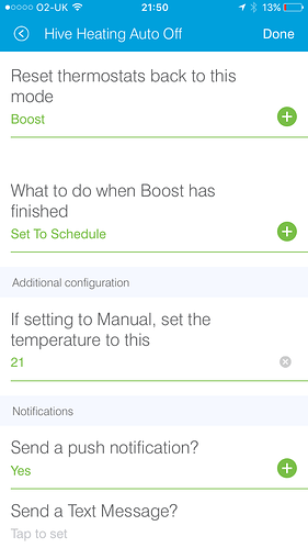

Right, here is the first BETA release of the Smart App that I have designed to work with Hive and Smartthings modes.
The idea behind this is that I wanted Hive to turn off automatically when Smartthings was in an Away mode and come back on when I arrived back. You can add different rules for Hive Heating and Hive Hot Water. In my instance, I set the Hive Heating to ‘off’ in my ‘Away’ and ‘Away Night’ modes and set to a ‘Boost for 60mins’ when it comes out of those modes. I have Hive Hot Water to ‘off’ in my ‘Away’ and ‘Away Night’ modes and set back to ‘Schedule’ when it comes out of those modes.
EDIT
  • Just updated the app and it now works with Switch events too since v1.1. This includes virtual switches.
  • Make sure you have the new v1.3.3 for latest bug fixes, improved boost handling and switches
@pillock let me know if this is what you were looking for
It should work with any Thermostat in Smartthings, but I had Hive in mind when creating it which is why I would love to get ideas and feedback for this app in this group first before I mention it on the main community board.
