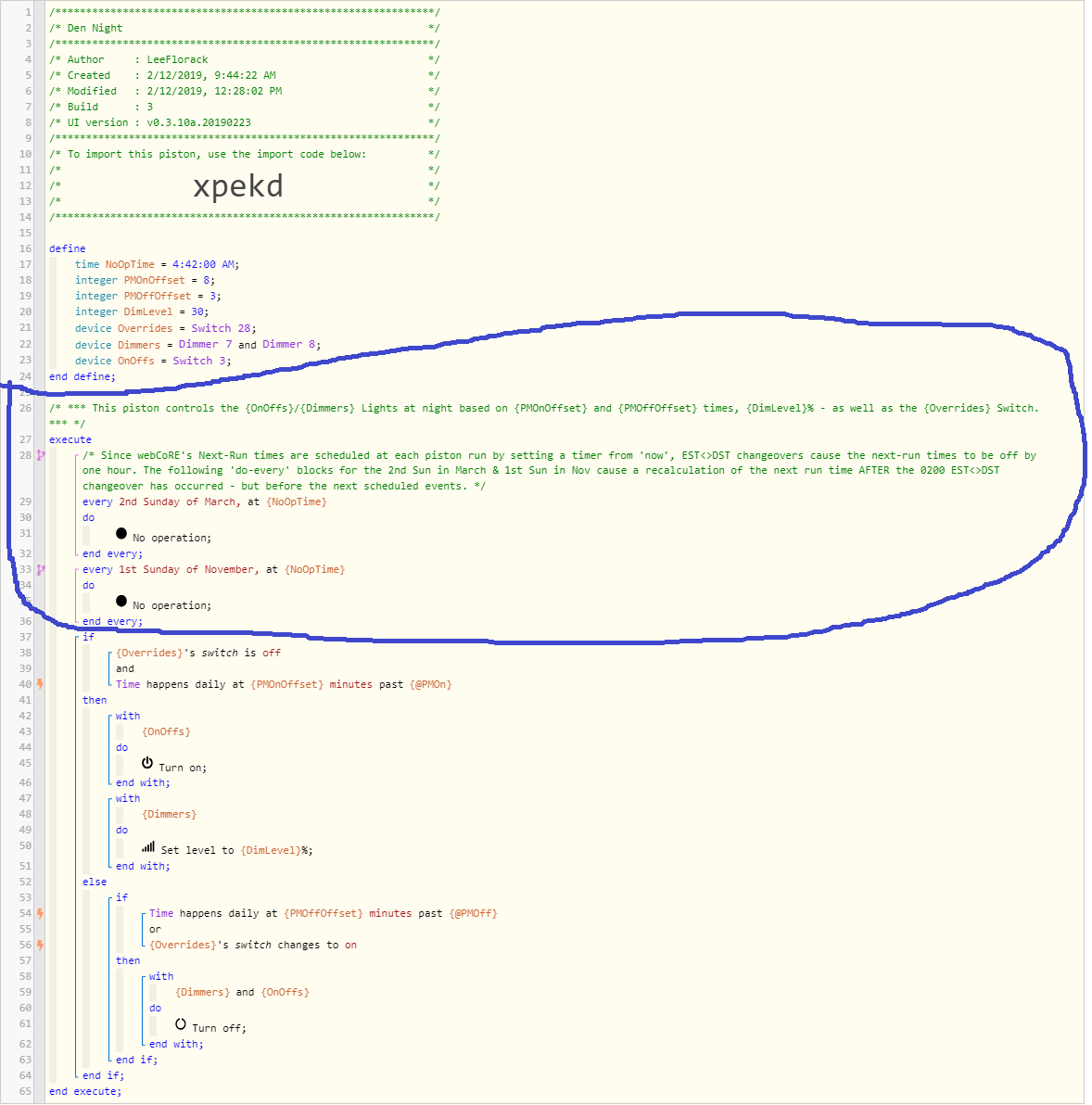

For the first time since I started using CoRE and now webCoRE, I did not have DST <> EST changeover issues this year. I believe this is because of the changes I made as described below.
I am currently using two different methods to end having to manually pause and restart each affected piston after DST <> EST (for me) changeovers. Both methods seem to work. I haven’t settled on which is better so I currently have both methods running. Each takes a somewhat different approach.
Method One pauses each timed piston and then restarts it so that it recalculates next-run times based on the changed time:
Method Two uses a NO OPeration task embedded into each desired piston. When the circled portion of this piston runs, it also causes the piston to recalculate the next-run times based on the updated time:
Hope this helps!
When I went to bed, my WebCoRE pistons were still off by an hour. When I woke up, everything was finally synced up.
-SR
That’s pretty normal for CoRE/webCoRE. Next-run tasks are scheduled at the end of any piston activity. So, if pistons schedule next-run tasks prior to a daylight time switchover, those piston will be off one hour during their next run. However, anything that triggers the piston to reevaluate will use the then current time to set the schedule for the next-run events.
So, if you’re willing to wait a day, daily pistons will fix themselves (time-wise) after just one day of being out of sync. If you have things that you’d rather not wait that day to resync, you can use one of the two methods I posted above to fix the next-run time.
