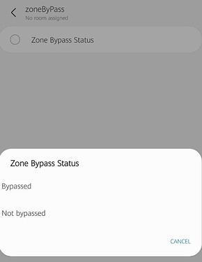

Anyone had any luck making modifications to presentation->automation json in the last couple days? Now that custom capabilities are showing up in the mobile app Automations tool, I’ve made some tweaks to my capabilities, but it’s been 24 hours and no changes are showing up. Could be it’s not fully functional yet?
Did you re-generate the VID after those changes? In your case, you need to edit the Device Profile and add the device-config file again (in case you modified the default configuration) and save it.

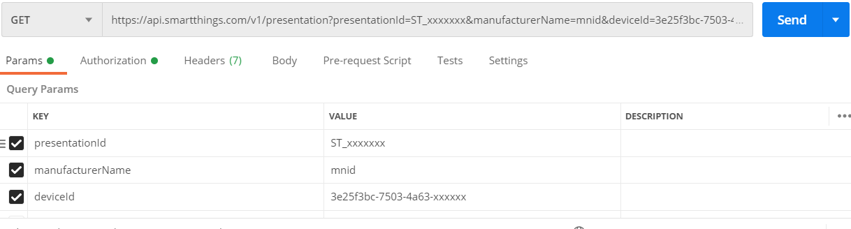

You can verify if your device is using the last presentation version by querying it using the VID, MNID, and device ID values, for example:
I have a number of similarly structured capabilities. I updated two capability presentations a few days ago and they appeared in the Automation actions eventually. It was a bit strange as one change appeared a few hours later but a second change to the same presentation made ten minutes later, plus another one made at the same time, didn’t appear until many, many hours later.
Yesterday I made the same changes to the other capability presentations. Not a sausage …
I checked all my files and they all have the same VID currently. If I download the json from Device Profile UI page, it has the same VID as well.
When you say “regenerate VID”, how do I initiate that, exactly? Is it supposed to change when I upload a new file? The ‘new’ device config file that I upload already contains a VID; should I not be including that?

When we query the presentation (VID), we can see all the capabilities’ presentation compiled, and there we can verify if the changes made (label, display type, etc.) are now included.
OK yes, I had done all that. And if I download the device config file again and check the Automations section, it is what I expected, however if I create an automation IF condition for the device, the capability attribute (zonebypass) is not being shown. (The same capability is also used by another device and it shows fine for the other device.)
Should I have to delete and re-add the device?

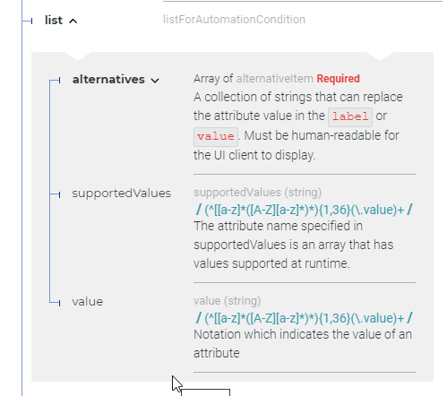

Doesn’t the list {} also need "value": "zoneBypass.value"? It wouldn’t know what attribute to use otherwise.
@nayelyz the API documentation documents this but the response samples don’t show it.
