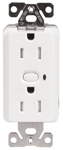

Eaton product:
Lowe’s Item #1614055; Model #RFTR9605-TAW-BX-LW
or just RFTR9605-TAW. 15 amp receptacle. Interesting feature from an Amazon review: “I have a large number of Z-Wave switches and receptacles in my house from GE/Jasco. The problem with their product is that there is no easy way to use a wall switch to control the Z-Wave outlet. this product has a control wire that can be connected (to white/neutral) on a traditional toggle switch and will turn the outlet off and on. this is great when you only have two wires in your switch box.”
