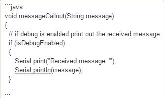

void messageCallout(String message)
// if debug is enabled print out the received message
if (isDebugEnabled)
Serial.print(“Received message: '”);
Serial.println(message);

Please surround your code with three back-quotes prior and after, or highlight and press the </> format button.
Like so…
  if (isDebugEnabled)
     Serial.print("Received message: '");
(Or paste a GitHub URL instead of full code.)
