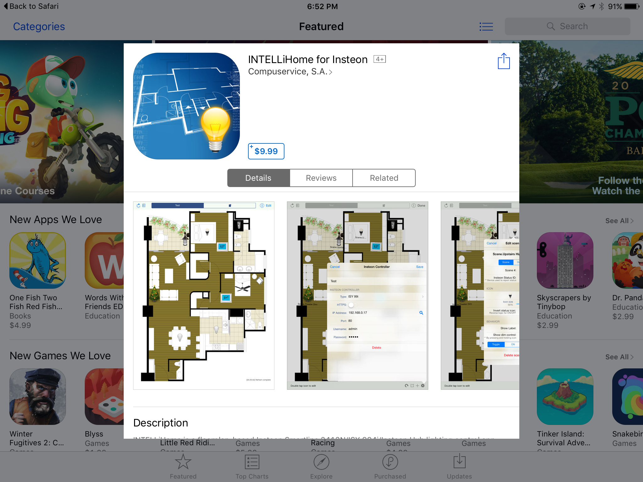

And there are a couple that work with Insteon and Homeseer, although the ones I’ve seen have fewer features than ADT’s. But they look nice.

Based on the ADT implementation, my guess is going to be that this isn’t something the customers know they want upfront, but is soon as they see it they see the advantages. So it becomes a strong value-add marketing statement, particularly if the official app doesn’t offer it.
It could even be a “step up” feature version that costs more, so that people who want floorplan view pay a couple of bucks more for the elite version than people who don’t and just stick with the basic. The point is just that it’s an instantly recognizable differentiator, “Q. what’s different about the elite version? A. It has floor plan view…”

My point is that as a marketing feature, the visible difference between the $9.99 version and the $14.99 version of the app might well be floor plan view, where The value can be shown in a single screenshot.
