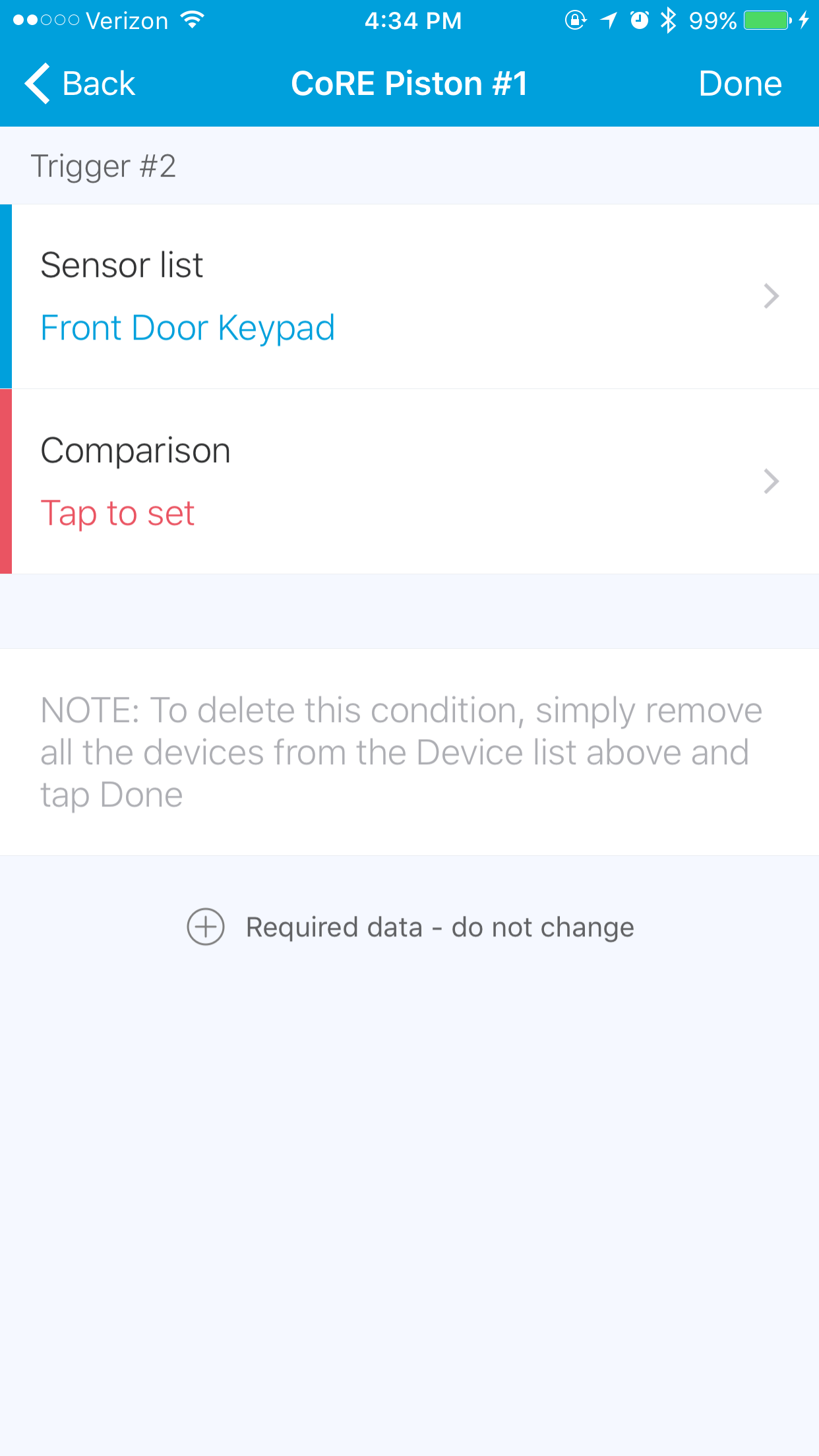

What capability would I be selecting in the condition?
Oops, I deleted my original text. Use “Sensor”, attribute “lastUpdate”.
See, now I’m running into the same issue I was having in the other thread. I don’t have the option of “attribute”. What am I missing here? I’m using iOS.
Strange, I just loaded the dh from the link you gave me. I’m on Android. Hmm
What could be causing this? Can someone with iOS confirm that they have the Attribute option?

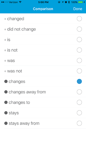

Hmm, wait, when you click Comparison, what do you get?

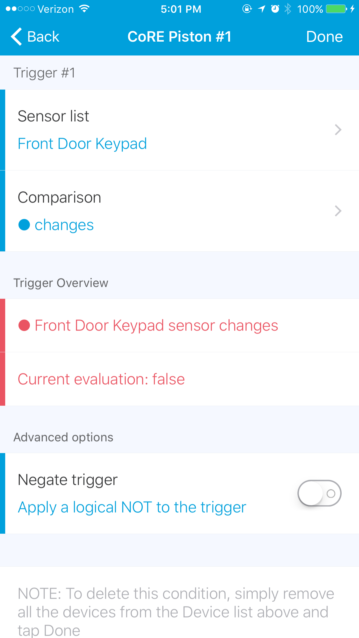

I’m stumped :slight_smile: After I select Comparison, Attribute shows above it where I select the attribute Current version of CoRE?
So strange. Are you using CoRE Version v0.3.169.20170104
Yep, same one. I thought we’d be able to figure out the initial issue but this has me scratching my head lol. I’d say ditch iOS but that’s too extreme :stuck_out_tongue_closed_eyes:
Edit: Enable Expert Mode was our issue for the curious :smiley:
