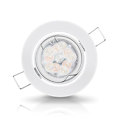

Sylvania/Osram makes some individual downlights which work well with SmartThings and allow you to dim either an individual lamp or group them together in any combination that you like, so they are quite popular for large rooms where everything is wired to a single switch but you want to create zone lighting. But these are just regular 230 V downlights, they aren’t part of a low-voltage system. Again, I am not sure if they would meet your needs.

  1. First, you can simply use a smartbulb. These come in many different formats these days, including the downlights that I linked to in a previous post.
