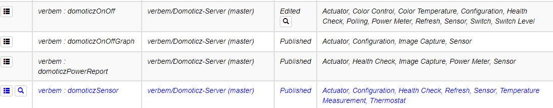

Just published the domoticzOnOffButton. The same set of DTH are still in the list and I still get the errors
i do not see domoticzOnOffButton??
That’s what I thought, but I have published it twice. Is it different to domoticzOnOff?

I have created a seperate child device per capability to be more dynamic in the tiles i show or not. It will give you a lot of DTH´s though…domoticzOnOffButton nis part of this repo
I’ve point to the new repo but still showing the wrong name. Not able to delete as used by other devices
Off to bed now but will have another crack at this tomorrow. Thanks for your help
Go to update from repo and the new devices should show, just select all and publish.
Do not delete existing ones they are not the same or a replacement, it is really a new one
Please select all, you might not need all of them, but no harm.
Hi Martin, I now have everything published, but still getting the error
Noticed I have domoticzOnOff and domoticzOnOffButton

There’s something I’m a little confused about: When adding the domoticz devices through the smart app, the mood switches still come in as domoticzonoff. I thought the device handler for these is now domoticzonoffbutton?
Also, the notifications sent from domoticz is on/off, so the group state is not sent to smartthings
Button is a child device of the domoticzonoff device, it will be added dynamically. Could take a little. You can see additional buttons appearing on the main device kitchen mood which behaves like a normal switch. If you click on the kitchen mood in the ide you should see the button device appear. You can use these mood buttons in automations
