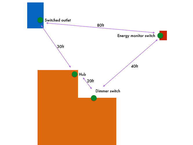

1. How can I tell if a device is actually connected at any given time? This seems like something that should be obvious, but I can't find it
2. Is there any way to see the mesh pattern? Maybe the mesh needs to be improved, how would I know?
3. Each device claims min 100ft, I've read the docs on repeaters and signal strength, is it likely that it's a connectivity problem?
4. If so, any ideas on how I can boost signal to that energy monitor switch outside? Not sure what I can put between the hub and it.

Is it clear line of sight between the devices? Or are there trees, mailboxes, cars, walls, etc. in between.?
Well the hub is inside, so there’s one wall between that and everything else. The switches are basically in the walls, so there’s just siding/shed wall between them and the outdoors. No trees, cars, etc.

So two walls. What construction: brick, Adobe, wood, siding, stucco, metal? Insulated? Is the interior wall paper foil or flaked? All kinds of things Dan affect signal. Classic Zwave in a typical US home usually gets about 40’ of signal, although in a cement house it may get only 15 or 20. Zwave plus is noticeably farther, but still not usually more than 60 indoors.
Zigbee is more commonly used to reach outbuildings, as it does a bit better through water, including rain and snow.
I get that walls, weather, etc. make a difference. What I really want to do is actually understand how much difference. For which I need some visibility into what’s going on. Is this available? Can I even tell what is actually connected and receiving pings at any given time? This seems critical… what am I missing?
