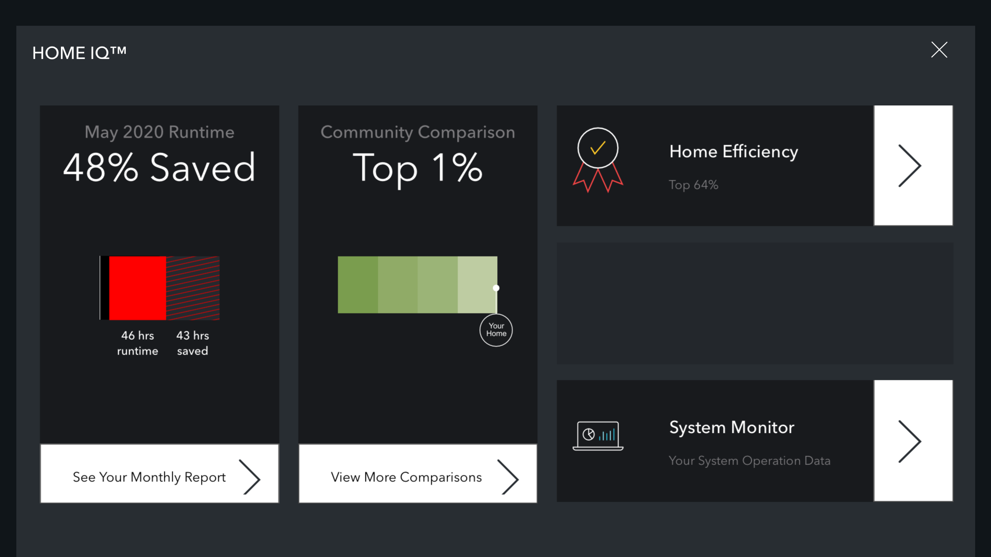

Screenshot of Upstairs System in 2019 showing runtimes. (Don’t know why the set point and outside temps are not showing…

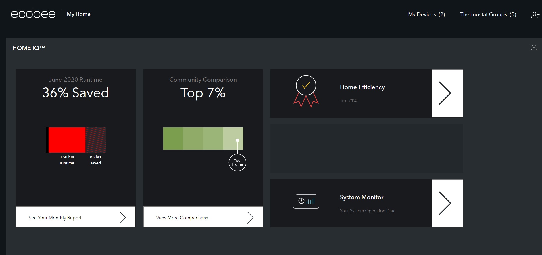

Screenshot of Upstairs System in 2020 showing runtimes. (System no longer constantly runs since I stopped using the Attic Fan Automation…
Previous years, I was in the 50% range and last month I was in the top 1%!
