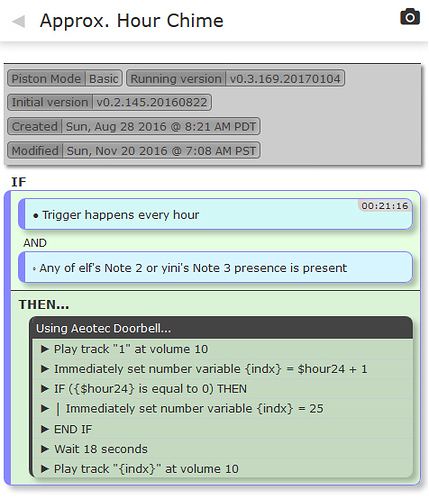

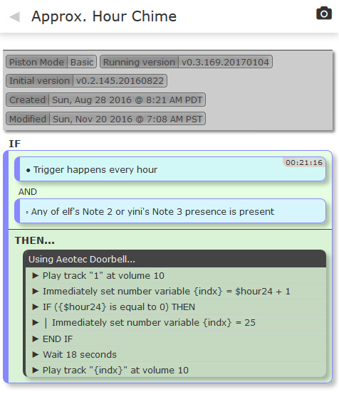

This is similar to my “cuckoo clock” piston, where it had to Wait 18 seconds for the first soundbite to finish before it could play the next one:
Might have to ‘borrow’ this and drive the wife cuckoo!
Yeah, the wifey has already mentioned that the volume needs to be turned down :grinning:
Hours 1 thru 12 plays tower bells, hours 13 thru 24 plays the cuckoo clock …
I don’t have a SONOS either, but if it’s true that you need the restore task in a separate action block, then just put the Wait task before the Restore task (in the same action block).
