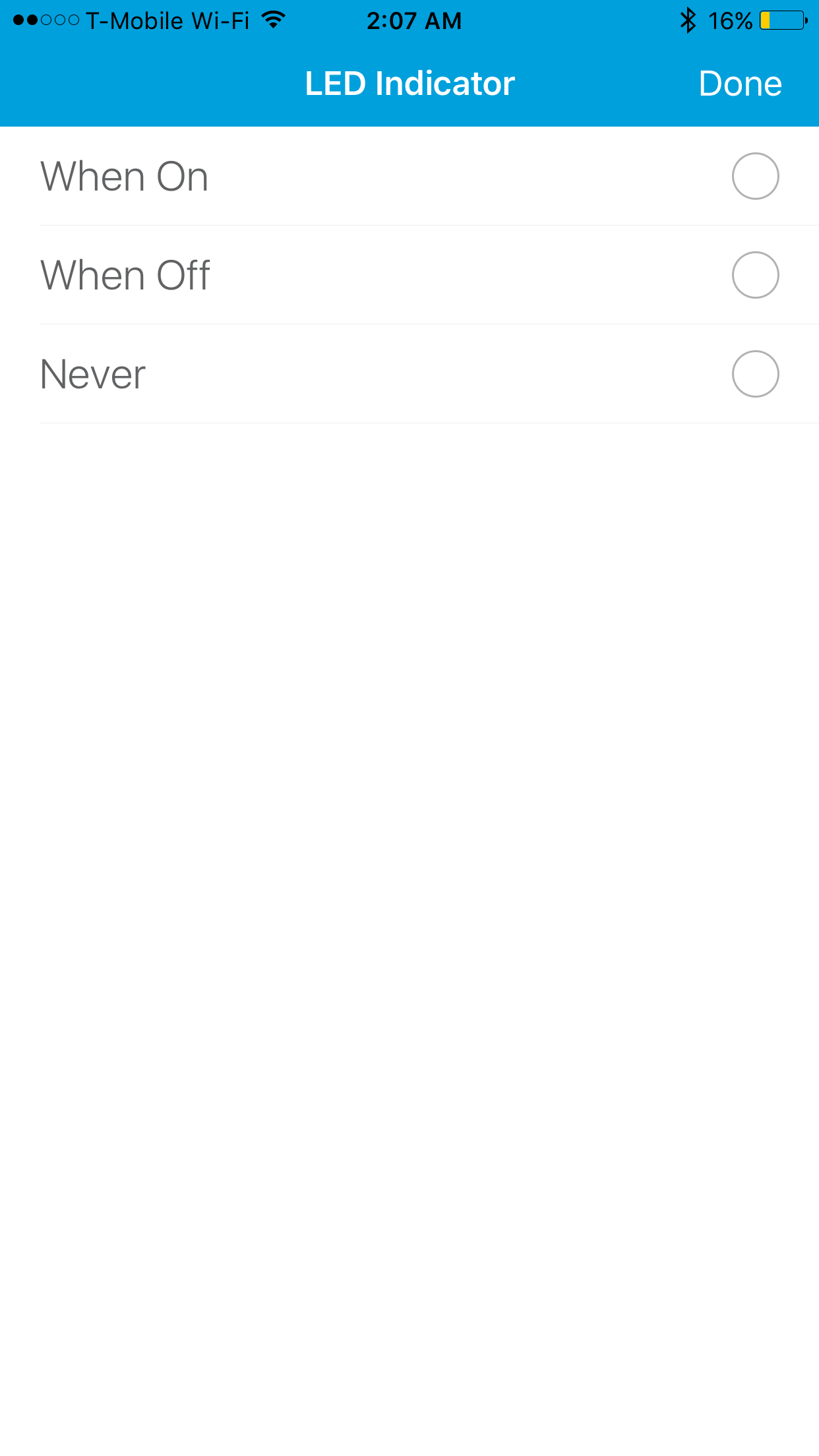

I’m trying to create a piston that will turn on the indicator light on my light switch when the light is turned off and only while my hub is in Night Mode. Here’s a screenshot of the device settings and what I’ve got so far for the piston.
I’m not sure if I should select never for the indicator light or not.

I’m pretty sure you can achieve this in webCore
That is a cool idea. I’d like to do this with a single webcore piston for all of my switches. Turn on indicators, only at night when the lights are off.
I went back into CoRE starting over and got it working. If you’re interested in what it looks like, here you go…
