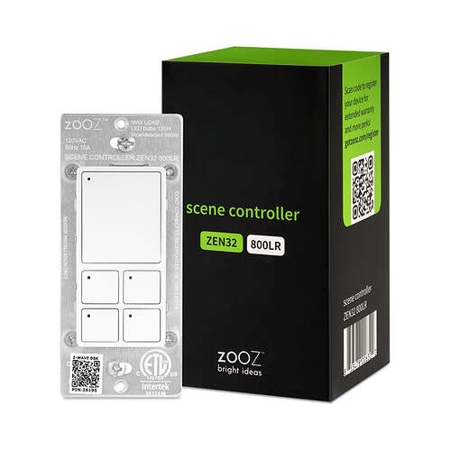

I run all my ceiling fans with Bond. The lights are separate and are connected to a Lutron dimmer. I use a Zooz 800 series for power and fan speed. Thought I’d share a few tips.
Create a virtual fan switch from bond with no light and program the speeds with any old ir remote. Don’t use RF. This will put the fan in SM with the speeds and power. The Zooz switch does the power. Program the speeds as individual generic devices using RF. This will put them in SM as switches. Just program your Zooz for the speeds and your virtual fan switch to the switches. I program the switches to turn off when turned on. This way they always send the RF command twice and the fan always gets its. Also creates a little delay so the fan will get the desired speed after power up. Any questions about this setup let me know. Lastly the LEDs are a bit of a pain. I program them to the switches as well. When one switch turns on it turns on the LED on the button corresponding with that speed and turns the rest off. You’re left with the switch showing the speed and the fan power being on.
