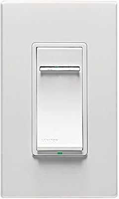

OK so according to the reading I’ve done there is a good chance that at least sometimes the light will flicker on when you’re doing the old “set dim and turn off immediately”. So I’m confident the GE switch doesn’t support the command to set dim without turning on. However, I just bought a different dimmer a couple days ago:
Leviton DZMX1-1BZ Decora Z-Wave
This has been mentioned in a couple threads and for some reason I feel like I read you can set the dim level while switch is off on this. Haven’t installed it yet… the buttons on the face of it are really weird and I wouldn’t say it has a clean look. That all being said, may consider switching to these if I can finally have the lights turn on at different levels based on what time it is.
Will report back once I install it.
cool deal, i’ll be curious to see your results. i ended up getting the RF9540-N which can manually dim up/down without turning on the light, but still have this issue. i’m betting it’s the DH at issue more than anything for these more advanced switches. it’s a pretty generic DH and we might need one that’s more tuned to our specific devices.
