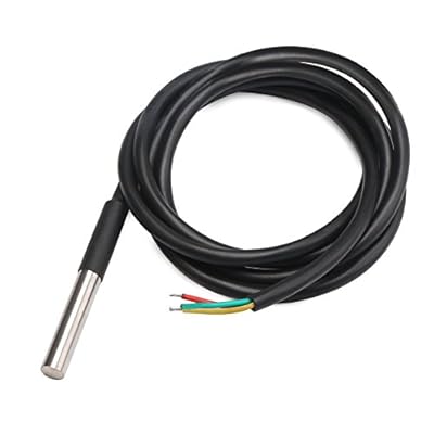

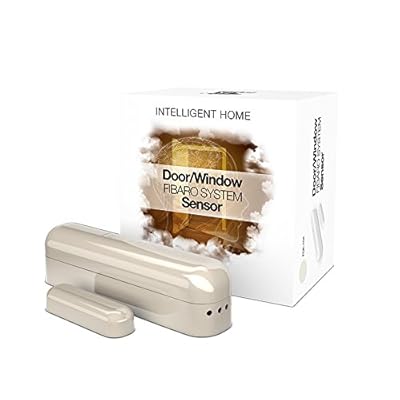

I used a combo of the Fibaro Door/window sensor and a DS18B20 to do this.
Basically I have the DS18B20 taped to the pipe, between the shower head and wall. I use rule machine to turn on the fan when the temp rises above 90 deg and off when it falls below.
