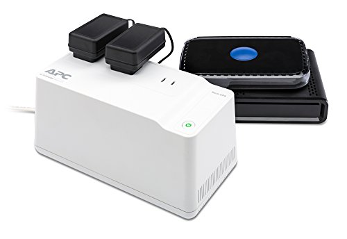

I have one of these running my cable modem, wireless router, and SmartThings hub. I caught it on sale at Best Buy for like $30.
