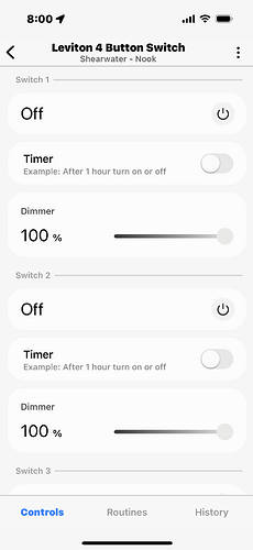

I have a device that controls 4 switches.

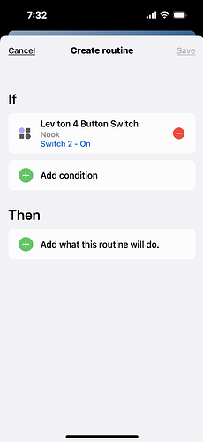

If I try to include this device in Automations, the behavior is:

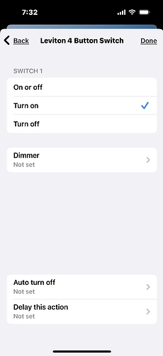

Any switch on the device can be selected in the IF clause;
But ONLY the main switch is selectable in the THEN clause:
This is true, even though I can send a command to any of the switches on the device.
