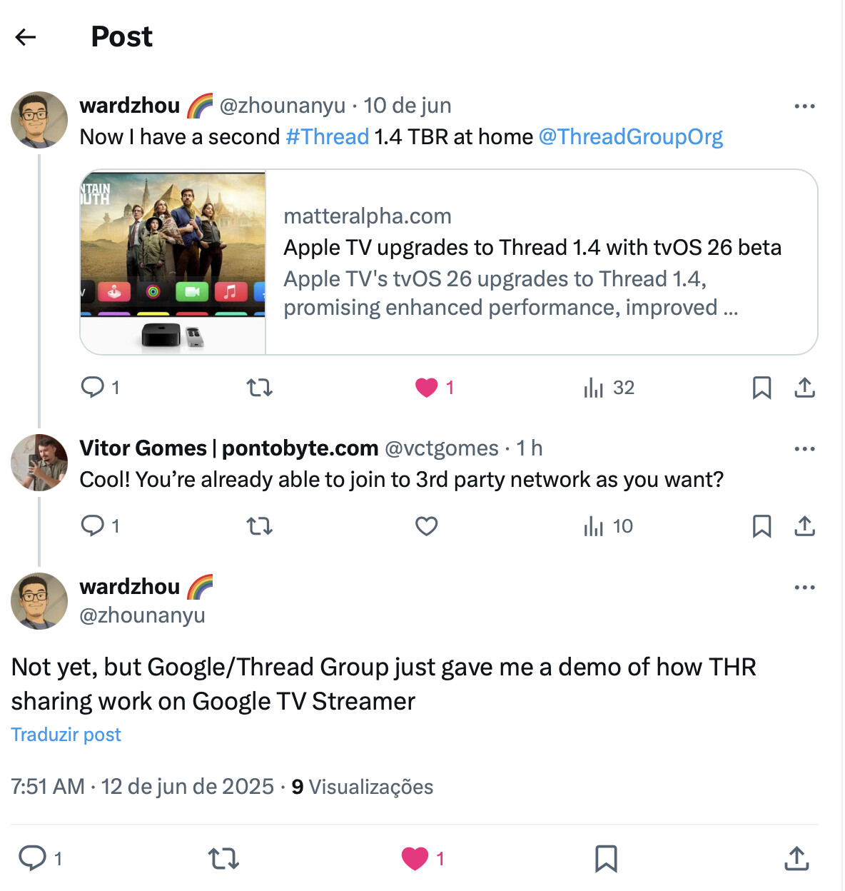

Thread 1.4 is a crucial update for Matter, as it fixes a number of problems and now Thread will finally be able to join, by default, to existing Thread networks, expanding your current network instead of creating a new one.
Apple just updated its Border Router to Thread 1.4, and Google, according to the Matter Alpha, is testing the update internally.
However, I haven’t seen any news about SmartThings yet.
