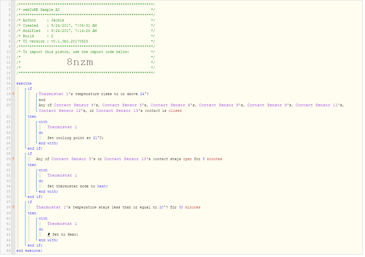

I just put together this hypothetical sample for you this morning.
The first section would turn on OC based on temperature and whether the windows are closed.
The second is the bit about the door being open. But I’ve had dicey luck with certain conditions lately Like Stays, stays away from, etc. They are supposed to work but you have to try each one with each device and see.
The third bit is about shutting it off if the temp is good for 30 minutes. But seems unecessary depending on what is controlling your AC. Also just realized I assumed you meant Central Air and not a single unit in a window or room. So this would change a bit. I also chose change Mode to heat because you used the phrase ‘shut it off’. My AC is controlled by my thermostat and will shut off when the thermostat reaches the desired temp. So if yours works different, I’d have to know.
At least this should give you a place to start.

Kinda late but you can restore/import that piston into your environment. One of the handy features of webcore.
To do this(if you or anyone else doesn’t know) you simply add a new piston, click the orange restore button, and then type in the short code towards the top of the piston. In this case it would be 8nzm.
Once you do that it will have you select the devices to put in place of theirs.
