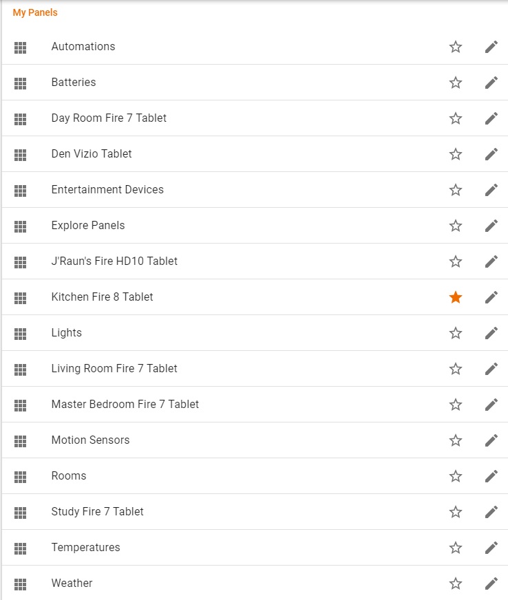

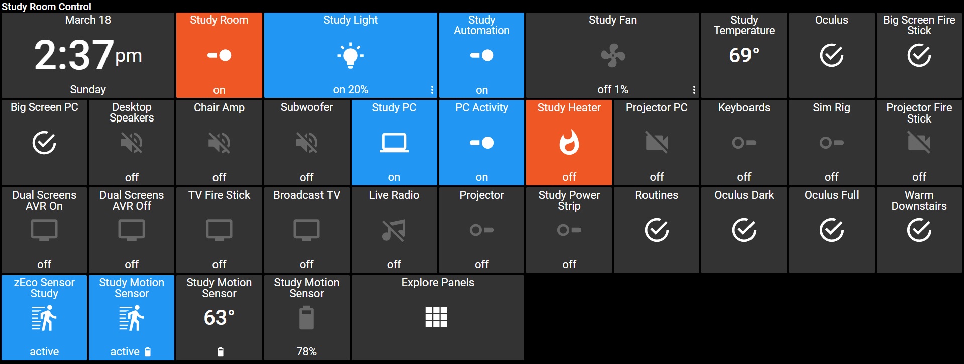

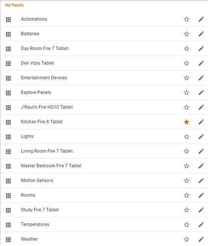

With Tablet pricing being so low and the flexibility that you have with Action Tiles, I chose to go that route.
I have a tablet for rooms either mounted on the wall, on a dedicated base or just sitting on a standing with a low profile cable attached. All are cool.
Beauty is each tablet can become the dashboard for any room! The options for controlling your SmartThings Devices and Routines are countless.
