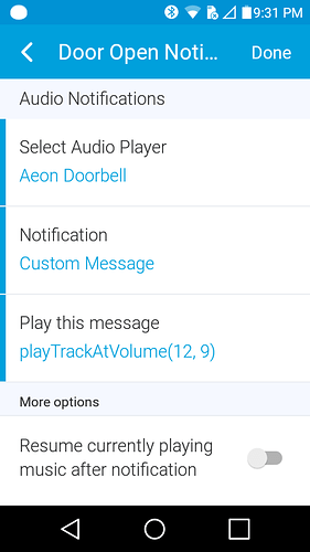

Trying to use the Aeotec Doorbell with your DTH and can’t get it to actually play a track.
Here are my settings:
Here is the log:

If you want to play track 12, the custom message should just be the number 12.
To play it at a specific volume, enter a number between 1-10 into the volume field.
