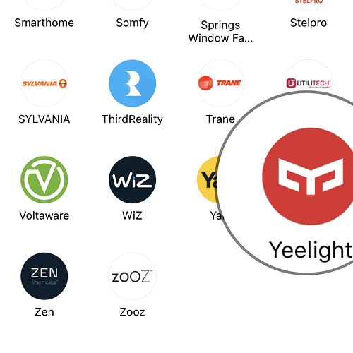

They added native support in the new app
The built in option now for Yeelight works perfectly in smartthings but I can’t get it to work properly via voice control on Alexa.
