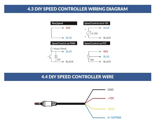

They list “Illumina RF” compatibility but after buying them on a hunch, they attached no problem to my Hubitat hub and worked fine once the driver was set to “Generic Zigbee Dimmer”. I’ve also figured out how to manage a few AC Infinity fans with them by removing the stock speed controller and using the Levition 0-10v dimmer signal instead…link above.
