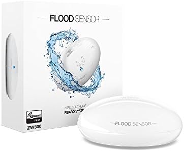

The Fibaro flood sensor is also worth considering, although it’s more expensive. It has three contacts instead of two, which is a good fit if the supporting surface is uneven. It has a tilt sensor as well as a leak sensor and the temperature sensor. The tilt sensor lets you know if it has moved from the original position, which can be useful for things like raccoons, small earthquakes, maintenance people etc. :wink: Designed for battery power, but if you are willing to drill a hole in the case they have instructions for hardwiring it. Has its own built-in “Siren” although it’s more of a beep alert. But the Sound can be useful.
So there are several different brands to consider, each with somewhat different features.
Thanks for the tip on the fibaro sensor. Really not sure what to do at this point. I was hoping since I didn’t want to do anything complicated I’d have an easier time with this. Since I don’t feel great about any of the packages has anyone had any experience with something like domoticz? Seriously thinking of getting a raspberry pi with a z wave stick and an open source software program. I have zero programming experience though so that kind of scares me.
