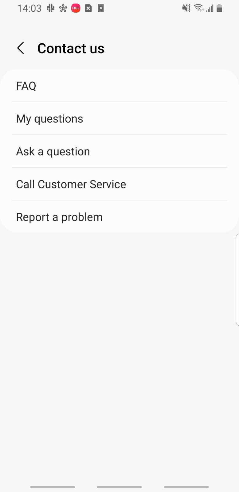

ok, then, please send a feature request for the Customer Support team to ask for this feature without involving customization/development and to have an option for users.
There’s an option in “contact us” that allows you to ask questions and you could include this request.
