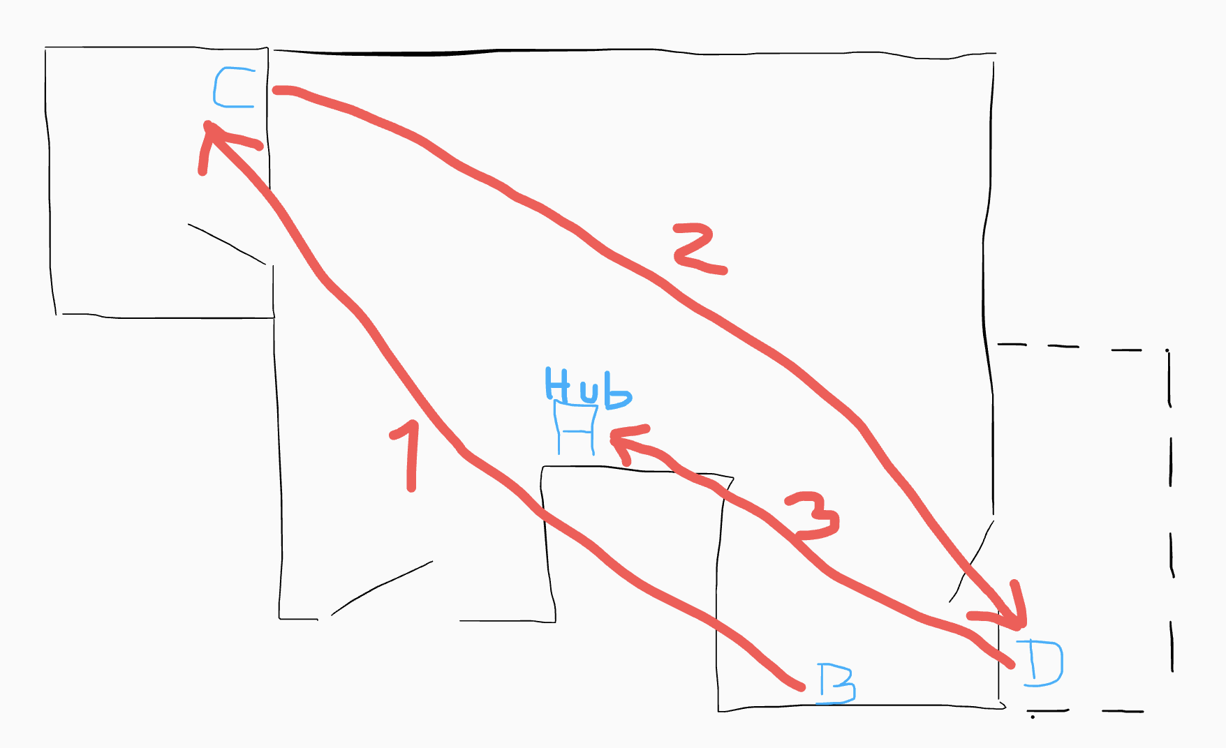

Several of my devices made strange routes connections, which I would like to change again. The below given examples shows a route from B to D to C to A. While A and B are only 4 metres apart and D is outside and C is on another level of the house.
Despite the fact, that I do not understand, how this was established - I really would like to sharpen the connection.

Just to complete the impression of a strange mesh, accept my attempt in children-drawing-style:
