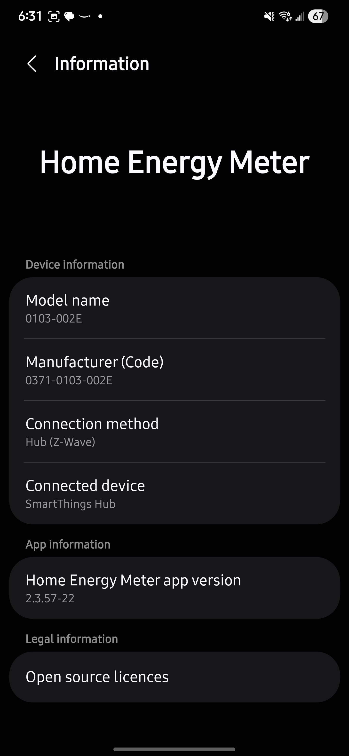

I bought the gen 8 aeotec 2 clamp system. I tried your driver as well as all other drivers
This is what I see with your driver and I have no settings option and it is not showing up in smarthings energy service. Any ideas what’s going on?
