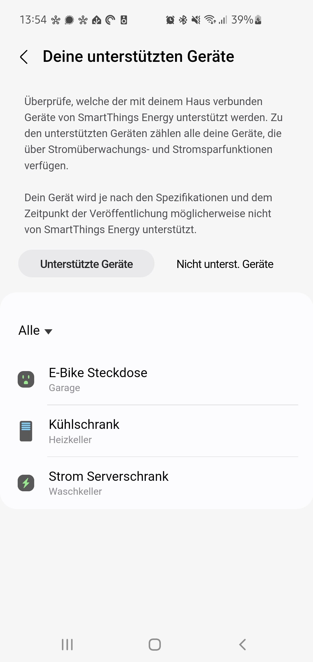

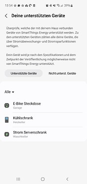

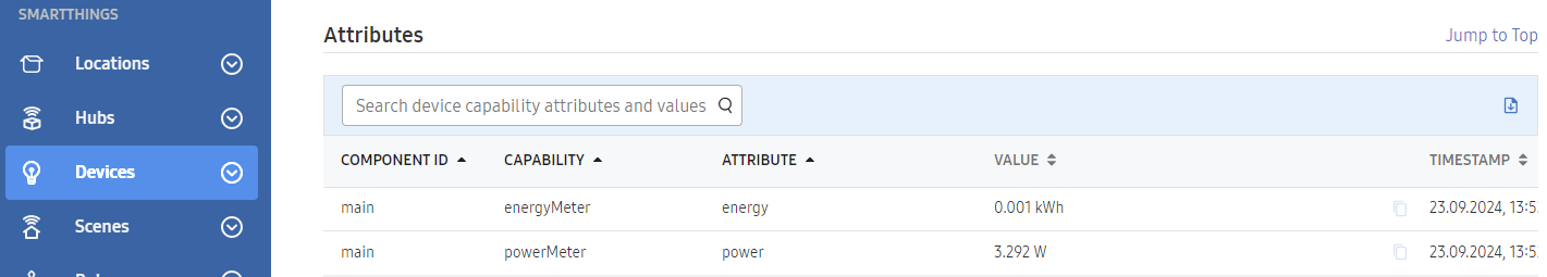

I have a very similar -or the same- problem regarding one Aeotec Smart Switch6 (called “Strom Serverschrank” in this scenario) which I integrated successfully into Smartthings.
It shows all the Capabilites/Attributes (energyMeter & energy / powerMeter & power within the device.
And appears in the supported devices section of the EnergyApp.
But it doesnt show in or is a part of the statistics and overview?
Aeotec is THE official hardware partner for Samsung Smartthings. Why are their Energy-Measurement-Devices not part of the supported devices within the EnergyApp (but Aqara Zigbee Outlets are by the way)?!

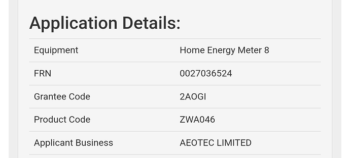

Side note: Aeotec might release a successor, the Home Energy Meter 8.

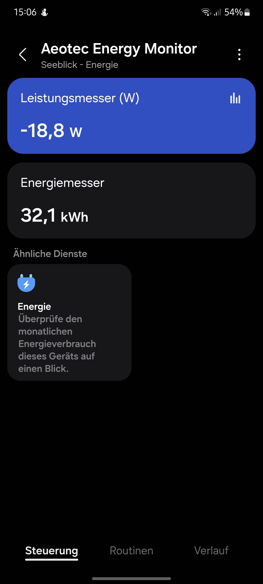

A few weeks ago I had the same experience as you. After the Aeotec drivers for the HEM Gen5 were updated, I installed the same driver as a test. However, Aeotec offers two drivers. In addition to the “Home Energy Meter Gen5”, there is also the “Home Energy Meter” (without the Gen5 designation). This is the only way I can display the data in the Smartthings Energy Service. This was also possible before the driver update. I use the HEM Gen5 with 1 clamp in Germany.
By the way the negativ Power (-18,8 W) belongs to my Solar-Energy.

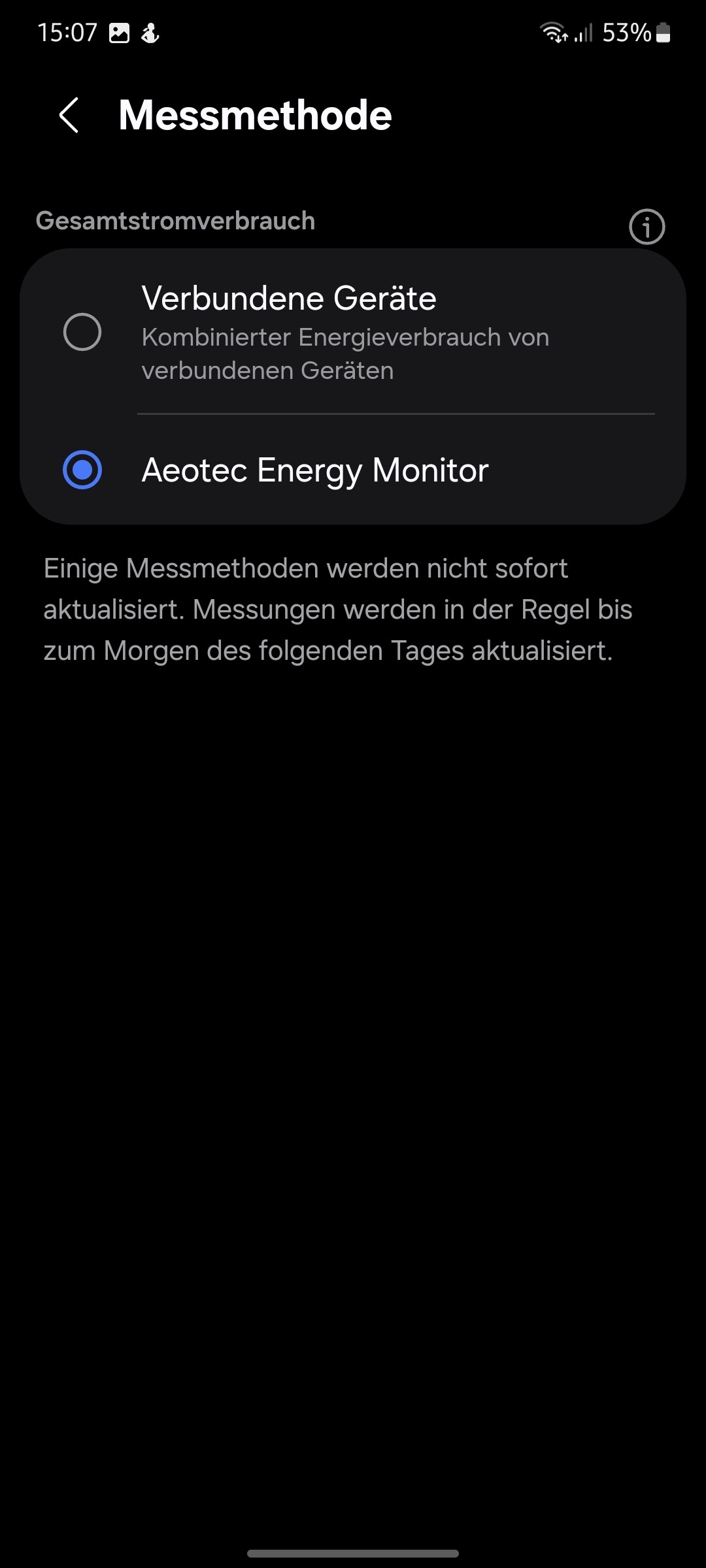

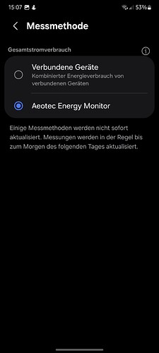

Hi, Thank you for the clarification. I have tried that and finally I can see the HEM Gen5 reporting to the Smartthings Energy Service.
So far, I did the following:
+Uninstalled all other Aeotec HEM related drivers,
+Removed the HEM from ST.
+Installed the “Aeotec Home Energy Meter” Driver
+Added the HEM back again and ST recognized right away as “Aeotec Energy Monitor Gen5”
+Then I uninstalled the Smartthings Energy Service.
+Re-installed the Smartthings Energy Service and the Service suggested me to add the new Energy Monitor. I did that and in about 30 mins I started noticing reporting the energy usage on it, so it worked as it should
Hope this process helps anyone else out there

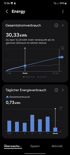

Last night I installed @Mariano_Colmenarejo driver after he integrated the Energy Service. All the data just keeps running and the HEM now shows the power meter (W) and energy meter (kWh) as well as the voltage (V) with history (24h/31d) and the electrical current (mA). What more could you want? It’s perfect!
