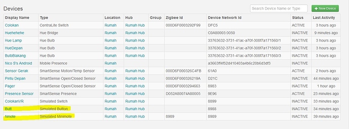

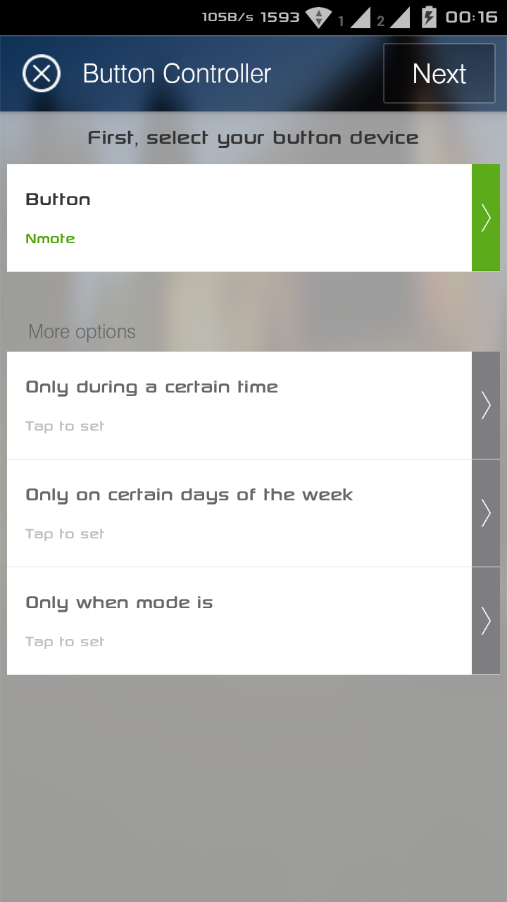

But, I have a problem, maybe you to help me with
I don’t have Aeon minimote yet, so i want to create simulated minimote, and do what you just tell.
But, I can’t setup my simulated minimote.
Let these picture explain
After selecting the Button, I tap next, and then this message shows up
My simulated minimote is already shows up on “things” menu, but I can’t install SmartApp
I don’t think that the simulation configuration for the Minimote Device Type is correct. I have not been able to get it to work in the past and it was easier just to use the real device.
I chose device type from drop down menu
there is type simulated minimote
Where is the configuration ?
Simulated switch is working fine on me
But simulated button and minimote didn’t
I use “Button COntroller” SmartApp to setup the simulated minimote, is there any other smartapp for minimote ?
There is code inside the SmartDevice Type Handler which is needed for the Simulation to work properly.
Often times that part of the Device Handler is poorly written and, for many Devices and Apps, the Simulator is just not an accurate simulation, IMHO.
Much more reliable to attach a real physical device for testing. Sorry.
