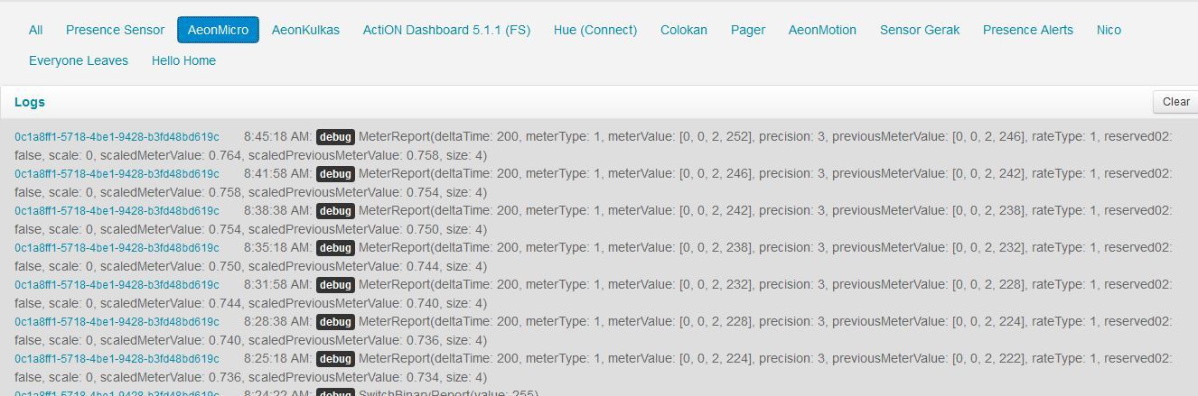

with default, everything works fine, energy report it’s value every 300 second, here’s the log :
I’m also able to change it reporting interval, for example, 200 second
310 second
But strangely, I can’t change the value far bigger.

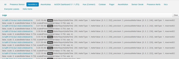

I change the interval to 480 second, here’s what happen
The interval time / delta time is not right. Never 480 second. it divided into to reporting interval.
120 s and 360 s . 115 s and 365 s
I try change bigger value, 720 second
here’s the log
