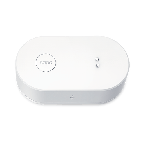

A water leak sensor?
Im not sure that those water leakage sensors are designed for everyday use like that, in addition its not so convenient to put it inside the shower

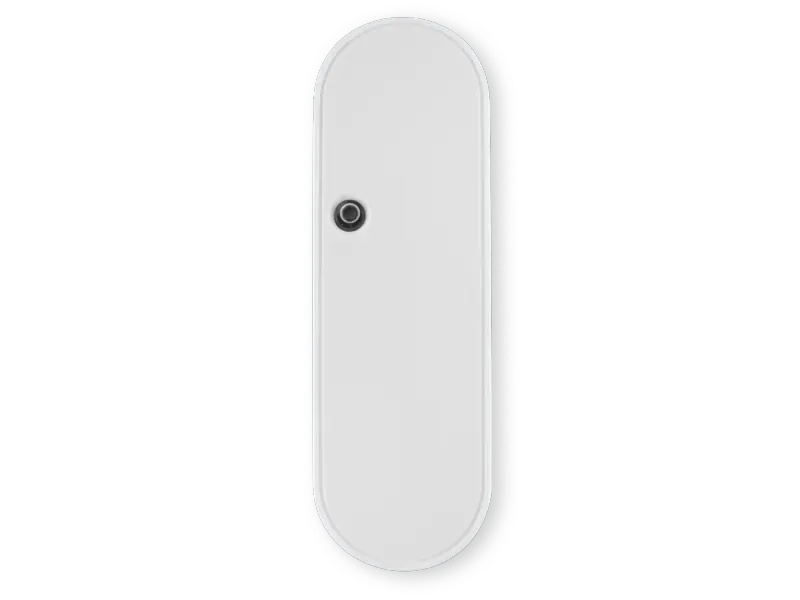

Is the shower powered or gravity fed - if powered maybe one of these (or similar) on the power line:
If shower > 0w pump on, = 0w pump off… Initial power report may not be immediate enough for you though - although no slower (probably quicker actually) than wet/dry report from a leak sessor :thinking:
Thank you for your suggestion, unfortunately the shower is operating by the natural water pressurised network, no power at all to detect and used as trigger for the pump :frowning:
