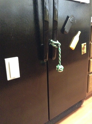

By the way, if you need equivalent functionality, use a $15 Hue White bulb in the Lamp and the Hue dimmer switch and you get the same functionality with about the same physicality required and it will also work even if your Internet is down. :sunglasses:
And you can put it wherever you want. This one on my refrigerator is at the height my service dog can use it. :dog::bulb:
