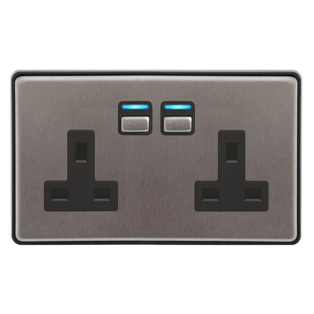

What I really like, though, are the second generation inwall lightwave RF power sockets. There really isn’t a good UK equivalent on the Z wave side as most of the zwave micros don’t handle the same wattage.
