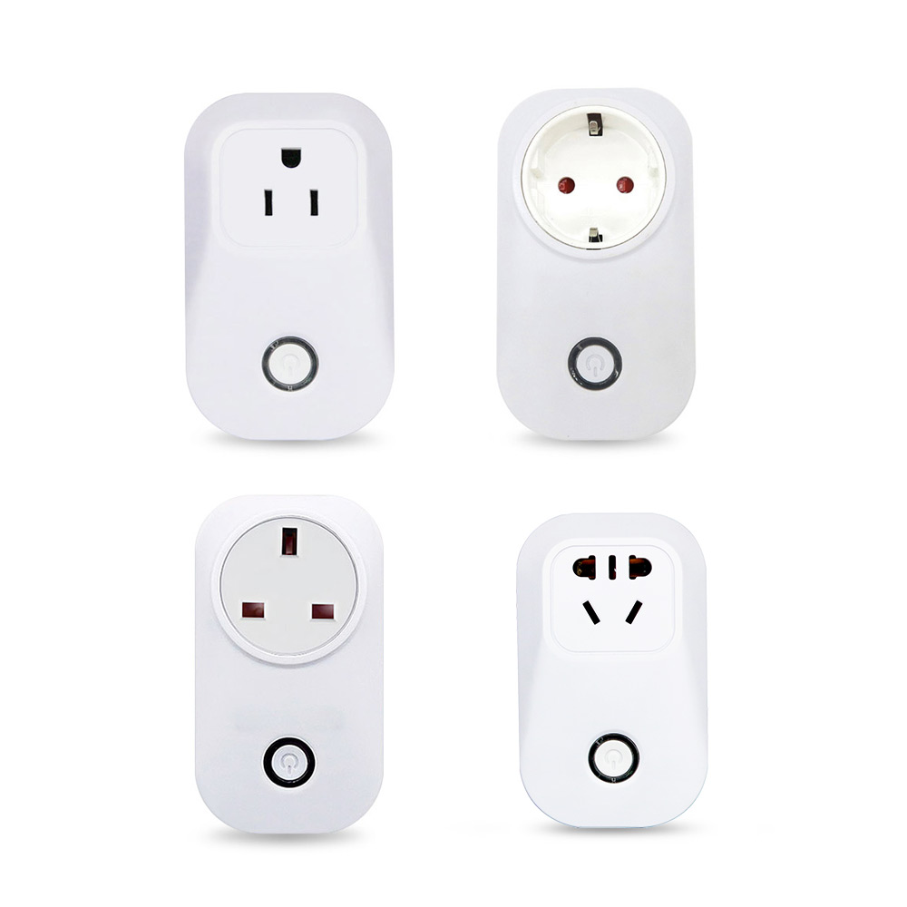

What do you mean by “pocket” socket? Just ST’s smartplugs ? Given that they are $60-70 in the UK , I just ordered a $20 US version and will test it out - I heard they are 110-220v compatible…
Sorry if that was confusing. In these forums we commonly use the term “pocket socket” for a plug-in module
To distinguish them from an in wall outlet:
Since so many manufacturers just call them a switch.
