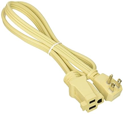

If you do go the way of using an Aeon dual clamp monitor, it’s easy to add a short heavy duty extension cord (up to 15 amps, 1875 watts on the one I’m using) to enable attaching a clamp to the extension cord to monitor power.
I used a sensor to identify the hot side on the extension cord when it was plugged in, and then unplugged it and carefully created about an 8" split in a section of the extension cord w/a box cutter, separating the hot side. I was careful and didn’t expose any wire, but I still extensively wrapped the resulting two sections of cord w/electrical tape. I then attached one of the Aeon clamps to the now available hot side wire and monitor to determine when the dryer (and same setup on my washer) starts and ends.

man i looked everywhere for this style extension cord when i posted earlier. Saved it in Amazon for the future.

I will be doing the extension cord idea with the cord suggested, using both probes of the Aeotec HEM. I’ll just plug the ST outlet adapter in somewhere else in the garage,

The extension cord is for the washer
