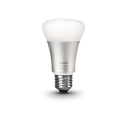

Bulbs: Only Phillip Hue bulbs are multivoltage, the same models are good for US and 220-230v countries.
Amazon have them on a special sale of 17% off when you buy 4. (still expensive)
You can buy also Osram or ant other bulb from Europe, but it would be more expensive. try amazon.es

About Philips Hue , it only supports 110V ( in its catalog) and by the way,
can it directly connect to SmartThings Hub without using any bridge?
Hope to hear from you soon.
I have just emailed the Philips Hue Website, they said that the bulbs will burn out due to not suitable voltage. However, they work perfectly in your case, dont they? Thank you for your reply.
For Philips Hue bulbs, do you need their hub or you can connect the bulbs directly to the SmartThings hub? Are all A19 Philips Hue bulbs compatible with 220V or only certain ones? Thank you
Phillips makes different models of their bulbs. Some will work with 110 V only, some will work with 220. The 220v models are sold in both the South American and the EU markets, so you just have to find a source for the ones that will work with your voltage.
It is best to use them with the hue bridge. While it is technically possible to connect a Hue bulb directly to the smartthings hub, it can cause problems with the zigbee network. Using them with the Hue bridge is the only officially supported method.
I only have z-wave devices connected to SmartThings hub, nothing directly to wifi on 2.4GHz, so should that be ok? Also, some reviewers mentioned that some A19 Philips Hue bulbs, even though they show as 110V compatible, they are in fact compatible with 220V as well. Thank you for your reply.
It’s up to you, but again, the only officially supported method is using the hue bridge.
As far as individual reviewers who say that the bulbs work with 220, the fact that they put the bulb in the socket and it didn’t explode doesn’t mean that it is “working well.” You could still reduce the life of the bulb, it could react badly to a power surge, etc. and the company will not honor the warranty if you use it with the wrong voltage.
The fact that the manufacturer tells you not to use that bulb with that voltage should be enough information.
