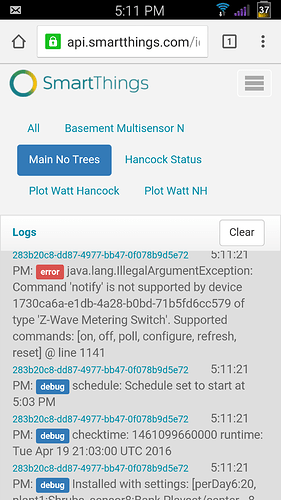

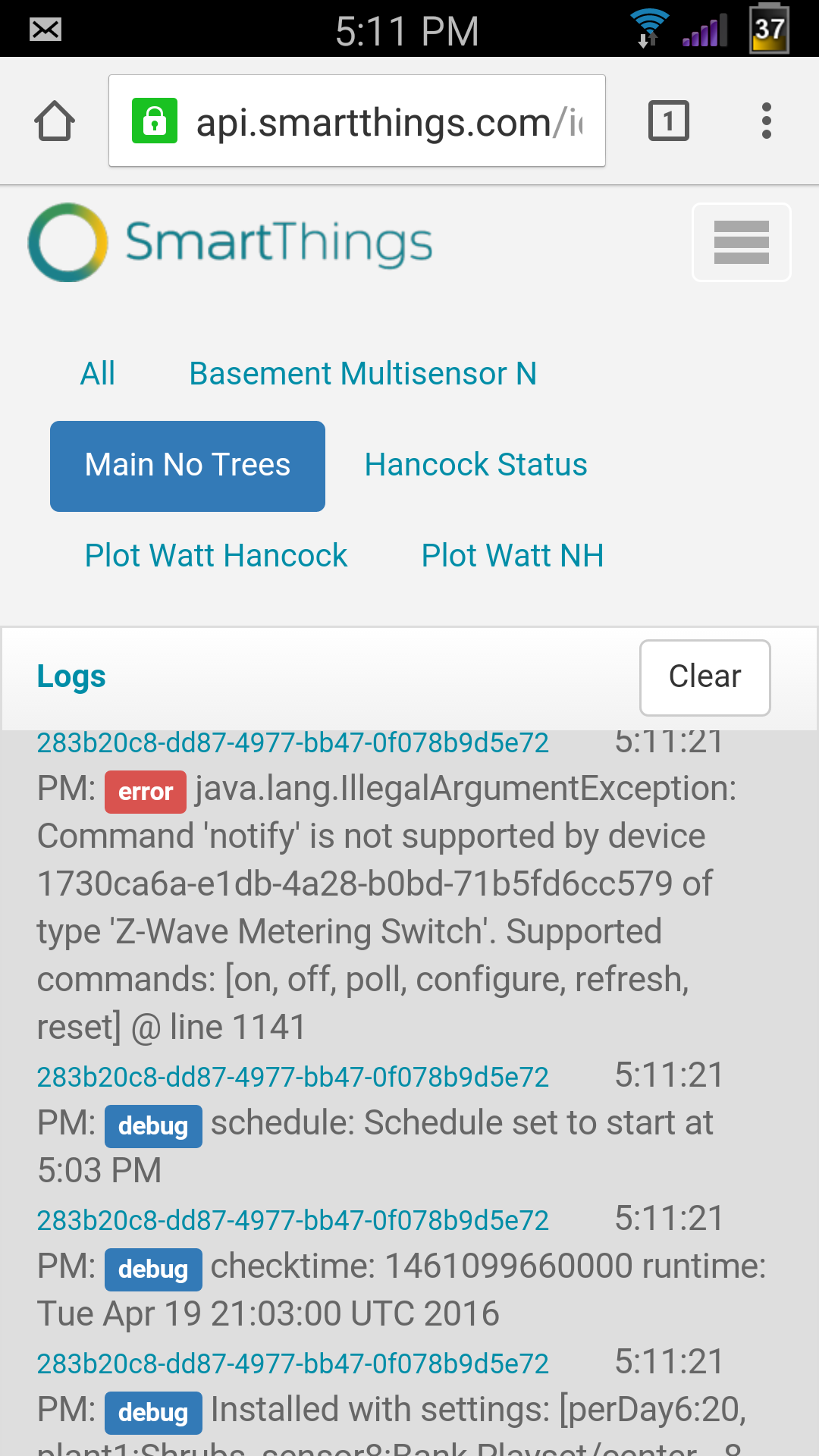

Running Android and.I am unable enable the smattapp… whenever I do ve I get an error. Please advise or I will have to return all equipment and my 12 sensors. No errors in log. I get aN unexpected red error popuP. I can save sub settings but not the main page
Not sure if this is your issue but Search this board for new app errors. You have to go in and unclick a box in IDE. It’s a Smart Things issue.

Actually tried again and.I.am getting an error in the i
de logs… see attachments.

In the screenshot the message is indicating that the “notify” command does not exist for the device. I see a “z-wave metering switch” is listed, this indicates that either the wrong device is selected in the schedule app or it is set to some other device type. This would definitely explain the app error or crashing. I would recommend checking the correct “controller” is selected in the scheduler.

. I thought the same thing and double checked that as I am a developer… I even unselected the scheduler and it still will not save and then reselected it and it still will.not save… see screenshot.

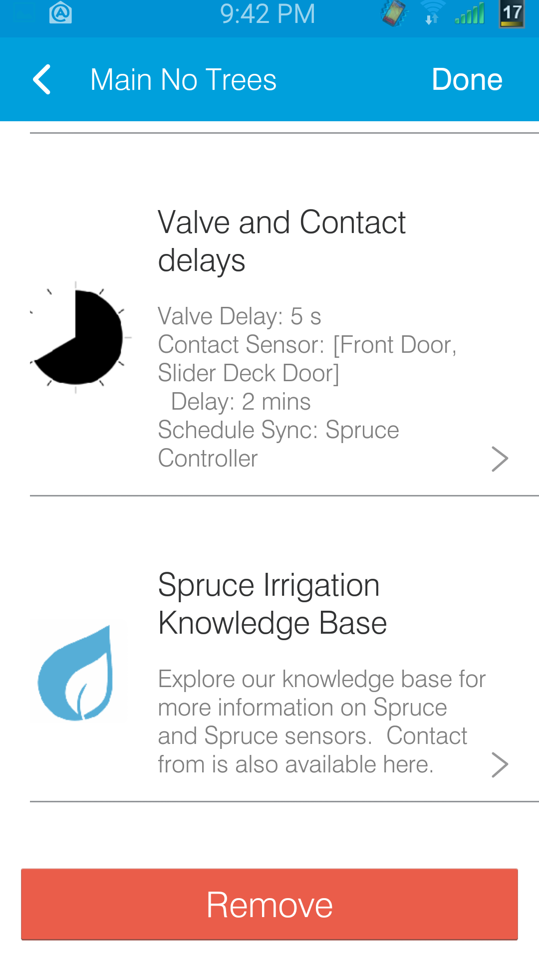

Sorry you were right there were two.places in the app you need to.pick the controller… not sure why it needs to be selected twice. But thanks.
I was setting the sync controller instead of the main.setting… my fault for not reading the fine print.
