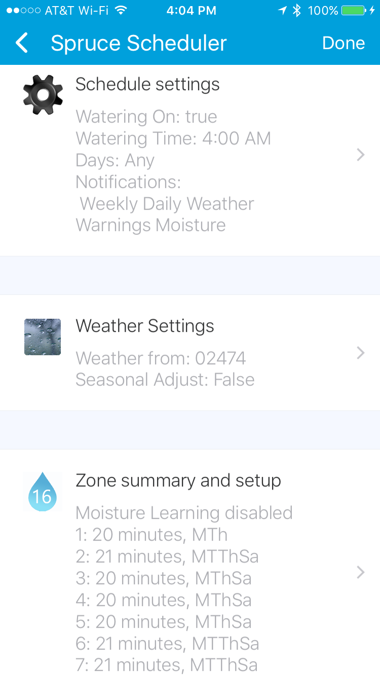

This is my settings
Weird. Mine fired just fine today. Moisture sensors were at 19 yesterday. I think it’s time to chat with Spruce support. They have been great to deal with whenever I had any issue.

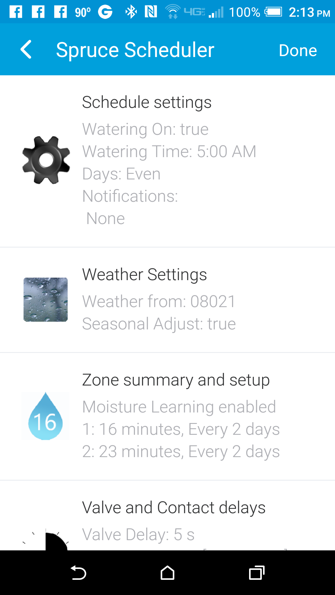

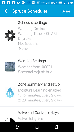

You can also post a picture of your schedule setup page as others above have done and/or the output from the schedule… found at: https://graph.api.smartthings.com/ Then log in and select “My Devices” then select “Spruce Controller” then scroll down and select “List Events”, Copy and past all the Events from around 4am. That hopefully would give us some info to point out the setting(s) to change.
Thank you that’s perfect… i failed to setup my zones… just completed and hopefully should trigger tonight

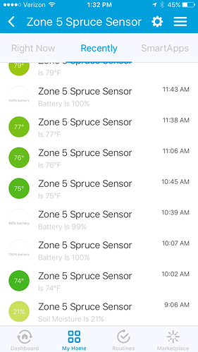

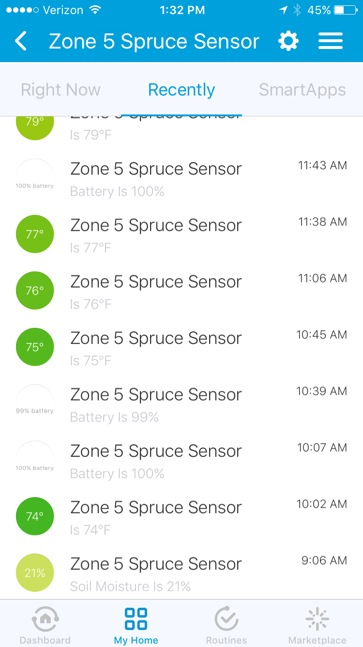

I have a spruce sensor that is reporting battery and temperature consistently, but moisture inconsistently. I have it set to report moisture every 10 minutes but that isn’t happening - see screenshot. I thought this might be a network issue, but can that actually be the case given that battery and temp are consistently being updated? If it is due to network issues, what can I do to improve that?
